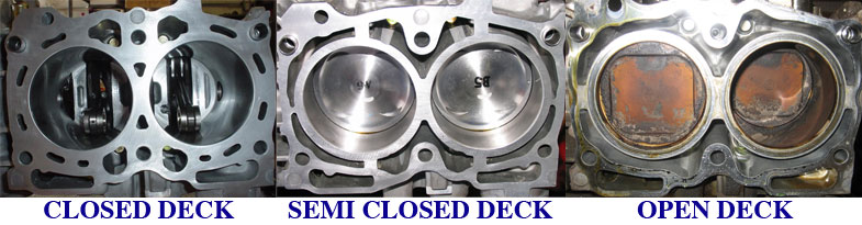

  1. Original image form http://www.rslibertyclub.org/forums/showthread.php?94919-Closed-deck-motors! not much info in one place hope this helps.. http://forums.jdmvip.com/How_to_tell_if_you_have_a_closed_deck_EJ20G_Subaru_Impreza-2796-t Alot of mixed info in this post I will try & edit later
