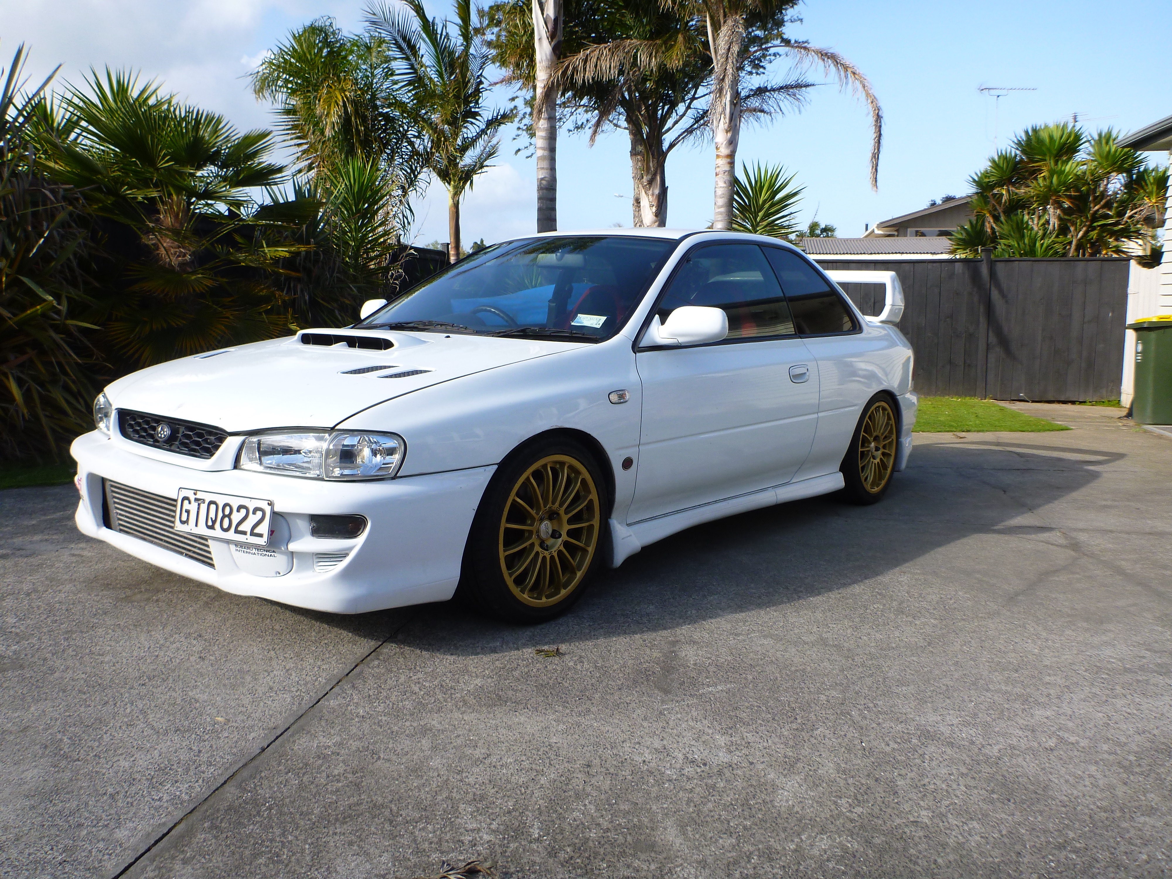

  5. So a few months ago my car (1999 STI Type R) developed this idle problem. It only happens every now and again. So not on every drive. But once it starts this idle it won’t stop until I have turned the car off and let it cool right down. It throws the code “24 air control valve”. I have changed this with a second hand cleaned one but problem persists. I have also put in a brand new air flow sensor. When it starts, I can be driving along normally then come to an intersection put the clutch in and the car will rev all the way up to almost 5k rpm, drop down to 1k rpm and pulse from 1-2k rpm. Any ideas or seen this before? Try a new IACV? Possibly an O2 sensor? Sent from my iPhone using Tapatalk

  13. I had a GTB legacy years ago and had a very similar problem. When cold, ran like a bag of dicks, when warm and on boost was sweet. I replaced the O2 sensor and fixed the problem. Sounds like you have changed a few components, try the O2 next. Hard to diagnose if its not throwing a code.
