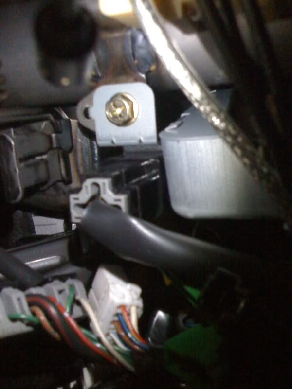

Hmm weird on the RHD its nowhere near there. Got a quote for $180 for module and $80 for labour.
I ordered the part from sub-a-roo spares $20 and 15minutes to install it. 1 minute to locate it (not counting above effort) 13 minutes getting the fscking screw out, and 1 min to attach the replacement. Pics for others reference.
Part
Location, Attached to steering wheel column
