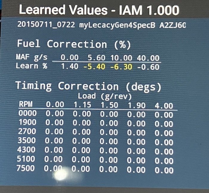

Attached below are my LV values and they do not seem to be too much off?
Do I understand this correctly, that with regards to the "Fuel Correction (%)" Learn % values,
a) a positive value indicates that the ECU has figured out that more fuel is needed as compared to the "standard engine with all ok"?
 -and-
b) a negative value indicates that the ECU has figured out that less fuel is needed as per the standard situation?

Idle is always crap after a reset as it needs to relearn so don’t look too closely into that.
Those learning view corrections are a bit high but not in the idle region
Have you got an aftermarket intake or anything on the car? The two mid figures would indicate something not 100% right
But since they’re still in a region where you’re not really making positive pressure in the manifold it doesn’t specifically point to a leak.
This is based on how it looks in the old windows program but still helpful.
