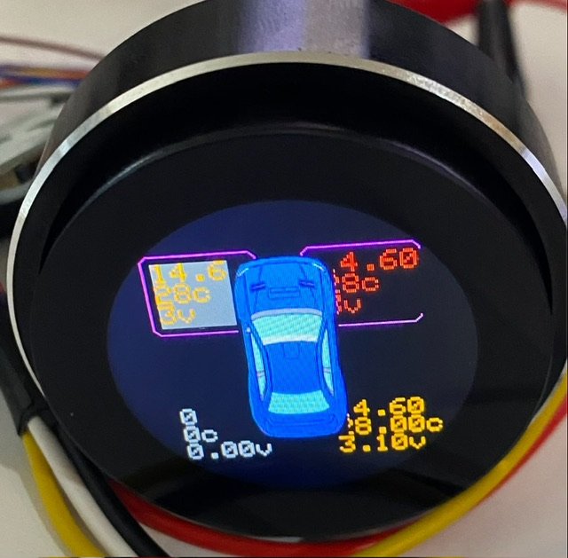

Tire pressure over Bluetooth round display that you turn outer ring to see different pressure units, and push to turn off display. It comes back on for new alerts etc. Can add sensor ID and working on a discovery feature. I theory the 2012 or newer cars could have this canbus the data to the OEM screen. The older cars have a physical wire to the dash lamp.

Early version of TPMS testing layout and colouring. Currently the magenta lines are grey and text is white unless alarm then red or orange.
Screen is 1.3” and outside is about 52mm
similar size to 08 aircon dials.
Thinking 3 will fit across a single DIN stereo panel size, so could have TPMS, G force sensor and something else.
