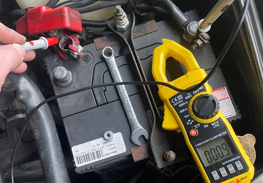

Issue 2 - I have continuity between my positive and negative battery leads  (wtf?) low resistance
I tested the same test on my ute and there is no continuity between my battery leads
Was thinking maybe the alternator could be damaged somehow, as I havnt seen it put out more than 13.4V but i do leave my battery on a trickle charger so I guess the alternator doesnt have much to do in terms of needing the make power

I can only get 2 circuits to change the resistance reading (resistance between +ve and -ve terminals with battery disconnected is 22kOhm) is when i unplug the alternator (at the 5plug) as soon as i unplug the alternator it changes resistance to 33kOhm, and the second one is the big wire fuse in the engine bay fuse box, when i unplug that it breaks the circuit - which is great but doesnt help me narrow it down
I tested alternator by running car with all lights and AC on and it produced 14.4Volts easy

Something is f***ed here, if you put a car battery across a 1 ohm load you get a good spark and a lot of heat very quickly. Unless everything involved is rather large.
Suspect something is kooked with your alternator.
Battery tests fine, no resistance between battery posts when its disconnected from the car
i only get resistance of 15ohms when i disconnect the +ve lead and test between +ve lead (not battery post) and negative  lead but yeah i realise thats f***ed haha, thats why as soon as i tested it i was like arrrrrrrr that not good

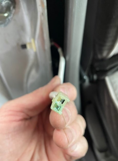

Omfg so after checking every circuit in the entire harness, resistance testing &volt drop testing everything
replacing alternator and battery
My power to earth connection short was my door switch wiring >_ <
corrosion had caused both wires to touch causing a short, and the corrosion in the plug was so but it wasnt enough power to blow the fuse
Now reading OL (0) between  +ve lead when removed from battery and earth lead

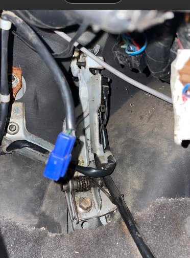

So I did abit of investigation based on the fault being Accelerator Pedal Switch
I found the switch - on the accelerator pedal - a small switch on top of the pedal
AND.............
its unplugged ------ omfg +_ +
Anyway there is no where for it to plug into
I have the ECU pin outs and there is no wire for Accelerator Pedal Switch
and I cant find any wiring diagram showing where it goes -_ -!
Any gurus out there got any ideas?

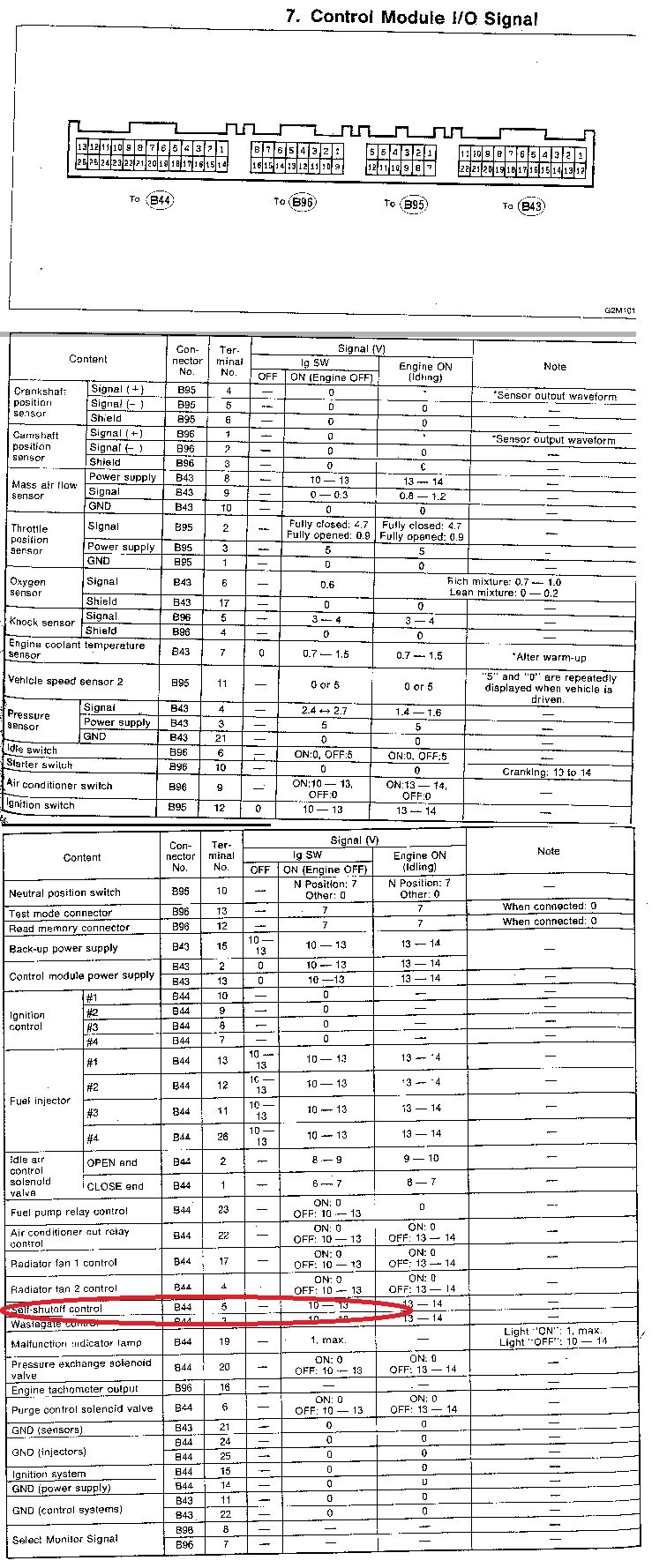

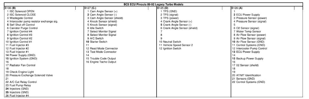

Pic attached

Yup, was thinking similar -
this Bc5 was originally Auto - the Ecu is from a Manual WRX Ver1 (Z4 ECU)
The Idle switch is built into the TPS and is functioning fine and not throwing a code (it did throw a idle switch code until i adjusted the TPS with a multimeter to spec volages with the car on, that fixed the idle switch code)
I got right under the dash with flashlight to have a look and there is no corresponding plug that the blue plug on the accelerator pedal to plug into - really scratching my head on this one

Z4 ECU Wiring Diagram doesnt show any additional input for any unknown sensor except (Self Shutoff Control)
Let me know if you spot anything
I found this https://xcceleration.com/pinouts/Subaru pinouts/ECU Pinouts BC5 BG5a WRX (4 plug) - Single Swap.pdf
and looks like adding wires for TPMs and it’s ground is needed. Possible the pins or wire is damaged or a joint cracked that won’t show up when the car isn’t moving.

the code 43 I’m getting is the code for Accelerator Pedal Switch for Subaru OBD1 codes - and it’s unplugged so I think first step of finding the plug - on that linked chart there’s a note that says C11 went to a blue plug that went to nothing so there may be an input for it I will check one day after work this week
This has been confused (because there is various OBD1 code translations saying the accelerator pedal switch code is TPS code) and because the ECU is from a GC8 so the GC8 codes apply here not the BC5 codes
