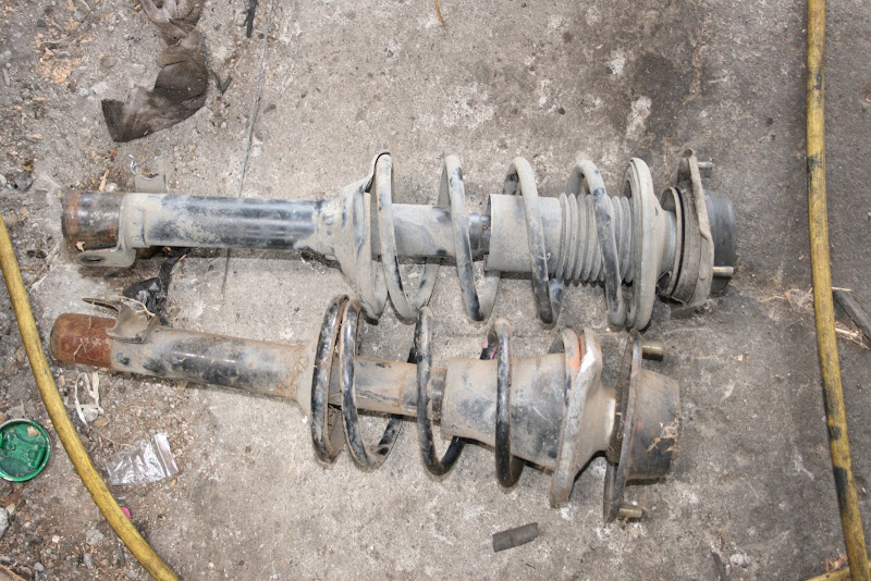

It all depends on how low you go, if you go to far you get horrible handling and it will become quite bouncy, im not familair with the older subs but I'd look at it and work out if you can cut them, as some springs coil inwards to a tighter diameter at the top/bottom so you cant cut that end, but look at the other end, it is really a trail and error, take the spring out chop one coil put it back in and do all the others the same,
Link to comment
Share on other sites
you can do that, you really want them to seat nice and tight in the factory boot, they are not illegal if they are captive so if you cut them and they are not captive just get the struts shortend, (it cost me $60/strut last time i did mine)

Yeah the spring shop guy round here will reshape your springs for about $40 each, hes got a little calculator on his computer that figures the spring rate and how many coils to remove to get the drop you want. Then he gets 'em red hot with a blow torch and reshapes the ends so they still fit snugly. Price may be different for you as i was getting a lot of other work done when i asked, but it could be worth a try

ok well tonight i started chopping 1 spring the front ''right'' all seems to be going well will take to a mates tomorrow and get some heat on it to make it captive and make it fit nice and snug. only problem is i didn't really know how much to chop off.. and may have got a bit grinder happy... I chopped off nearly 2 coils..??

 boostin said:
I'm thinking that's too much.... :o
hmm thought that could be the case.. but dam those springs are under a far bit of pressure had it in the vice undoing top hat bolt next minute sh*ts flying everywhere...shot the ratchet out of my hant top bolt went flying and spring shot off too... i always wonderd why u needed those spring compressor things.. Now i know haha :D
