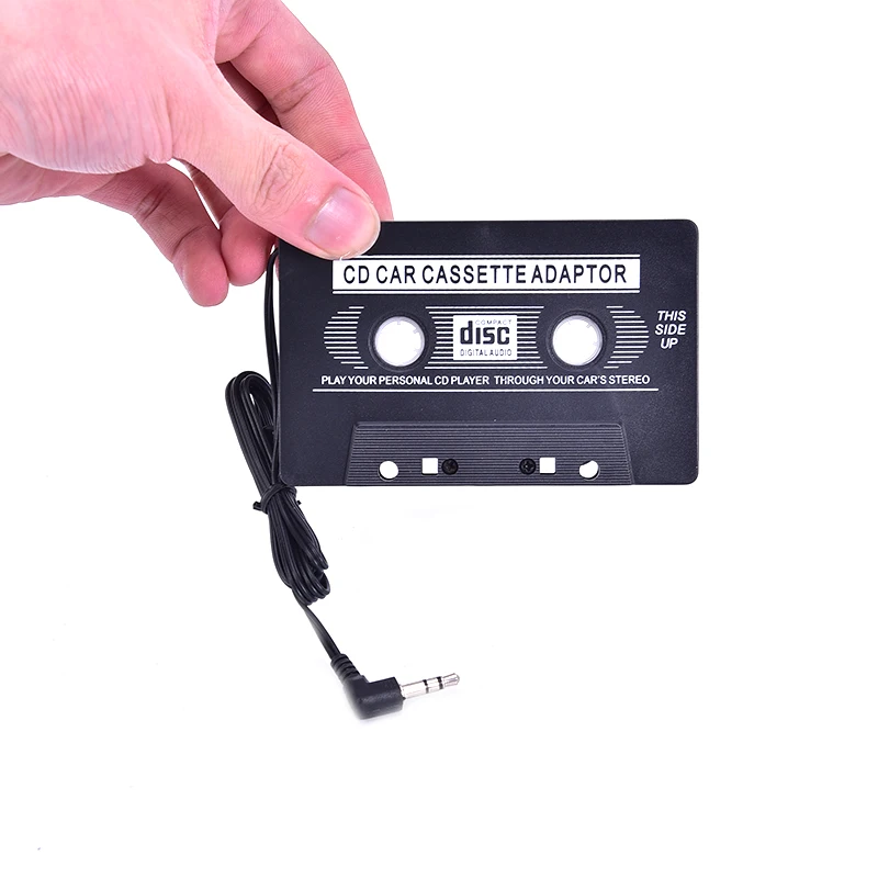

let me guess the factory stereo has one of these in it?
Or the newer Bluetooth ones
