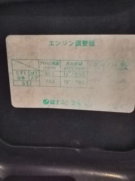

  4. Cheers guys, all top info. Will check the turbo after work. Bonnet is def alloy so looks like that's the only sti bit haha. Is indeed a 5 speed. Either way I'm happy. A complete wrx that seems to run ok for $675. Can't complain
  5. Hey cheers for coming back. Yeah that is pretty much what I'm trying to work out, is it an STI possibly. The engine has intake AVCS, bolts on the intercooler are missing, so are the hose clamps on the small hoses off intercooler at front. but rest of bay is very intact. Possibly intercooler was swapped. Pics below.
  6. Hey All, I just picked up a new project from an insurance auction. It's a 2000 Impreza wagon. Being stolen recovered it has had it's build tag removed unfortunately. Took it for a quick drive last night after getting it going. Runs well so happy with that. Just had a few questions about it. Undecided as yet if i'm going to try and use it as a motor swap for my blown up gtb legacy, or autocross it. Car is badge impreza 20k, would this be an EJ205 car? Any way to tell 205 from 207 visually? Reason I ask is the car came with a mismatched bumper (wrong colour, cut for a front mount) and there is a sticker for timing the car from the factory on underside of bonnet that only lists information for two STI models. Was just wondering if it could be a V7 wagon with the sti bumper pulled off by the idiots who stole it. Cheers guys, any info appreciated.
