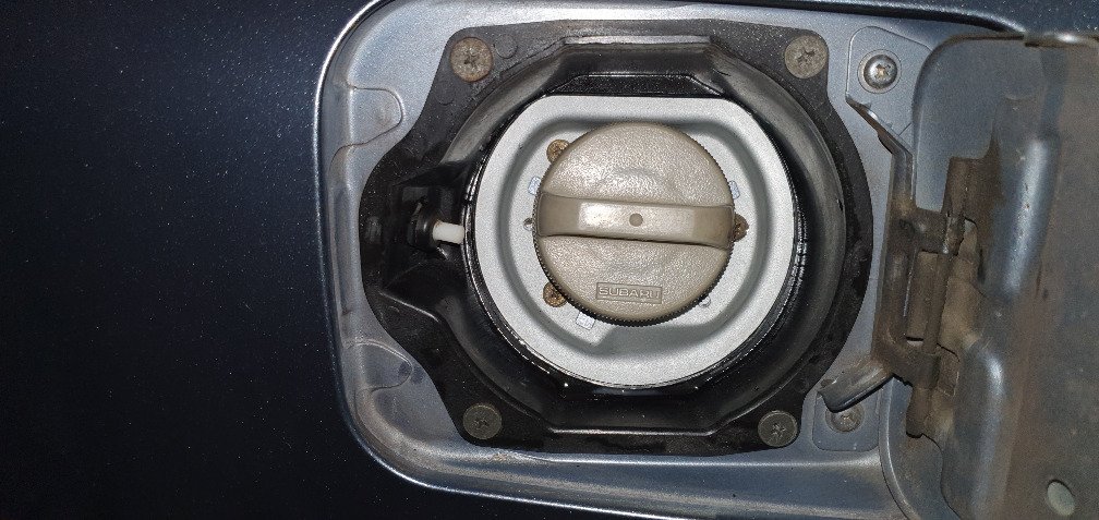

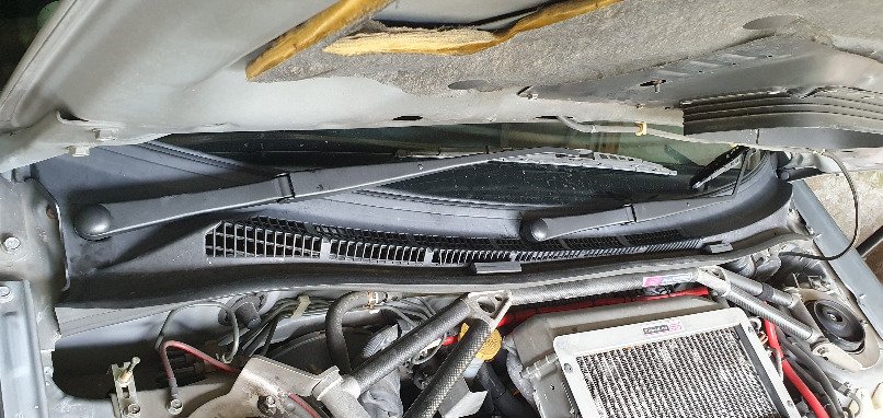

  16. Item 1: Fuel filler surround: Item 2: Wiper arms: Item 3: Boosty gauge, with special mod:
