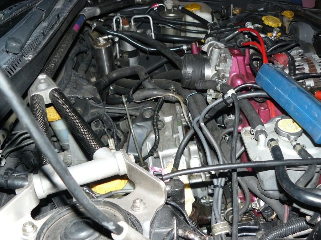

Just took another couple of pics....

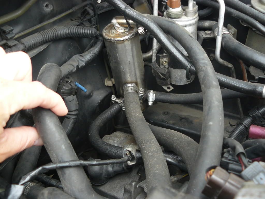

Front and rear breather, both going to the catch can.
All lines to catch can..
swap top hose "to right hand head" with the "to intake" and it should cure your oil issues. note your can will actually fill up now.. and might still mean its rings are pocked and shunting out more oil than is supposed to. Or that you have the two breathers going to the catch can like Koom said haha.

Can anyone confim the way the hoses should be located on the can?
I agree, but I only have excess oil when the turbo boosts, basically I think its sucking it out of the engine through the catch can. In the pic below you can see how its set up. The line on the far left at the bottom of the can is going to to the intake.
The line on the top on the elbow is coming from the right head breather, basically it would act like a vacume pump under any sort of boost. I think.
Im of the opinion the lines need to be swapped around and the problem will be solved.
Removed my vf23 to replace with a vf30. The thing is I dont think its knackered now. I think the lines in the catch can have been put back together wrong and that where the oil is coming from. Instead of the top line going to the intake a bottom line on the catch can is. Any oil in it would be being sucked straight into the intake.
I think my turbo has been "sucking" the oil out of the catch can from the engine when it is on boost. This would explain a couple of things but someone may be able to correct me?

Fitted a v7 sti blow off valve, plumbed it back. Car is running mint now, no fumes and a working blow off valve.
