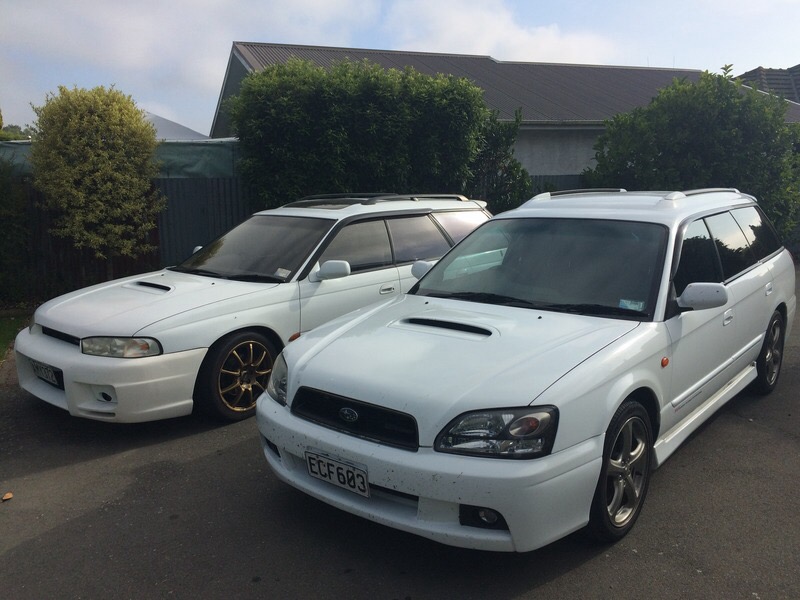

  25. Didn't do anything today but in the weekend I did an oil change on the legacy and the commodore and while having a quick look for leaks on the legacy noticed that the bolts on the passenger side coil packs were undone and the bracket for the O2 sensor on the bottom of the cam cover wasn't even attached... I'm guessing the mechanic who did the cambelt forgot check it all over when he finished. Oh well? I guess I won't be using them anymore. Especially since they are always reluctant to do anything on the legacy. I also switched my headlights to the gtb projectors!
