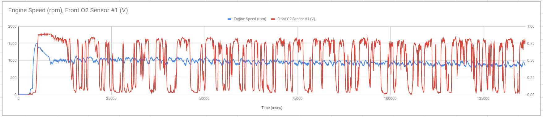

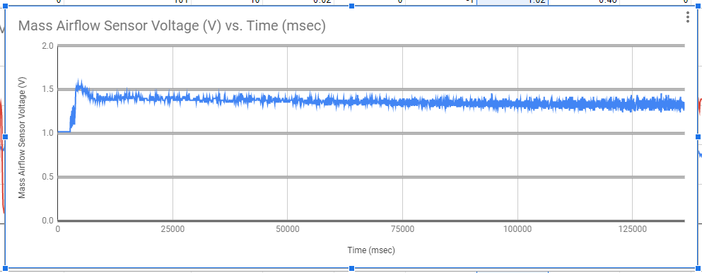

  9. Nah, stock BOV. Yeah, that's why I logged data from the ECU. I seemed to be getting realistic data from the MAF sensor, but keen to hear your opinion. Here is MAF data on cold idle: And here is the O2 sensor & RPM. It's all over the place, and shows the idle speed flapping around too. I logged heaps of data, but it's hard to show all on one graph. Let me know if you want to see any other data. Cheers Chris
