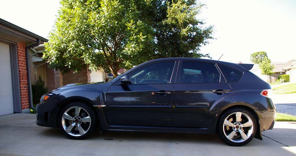

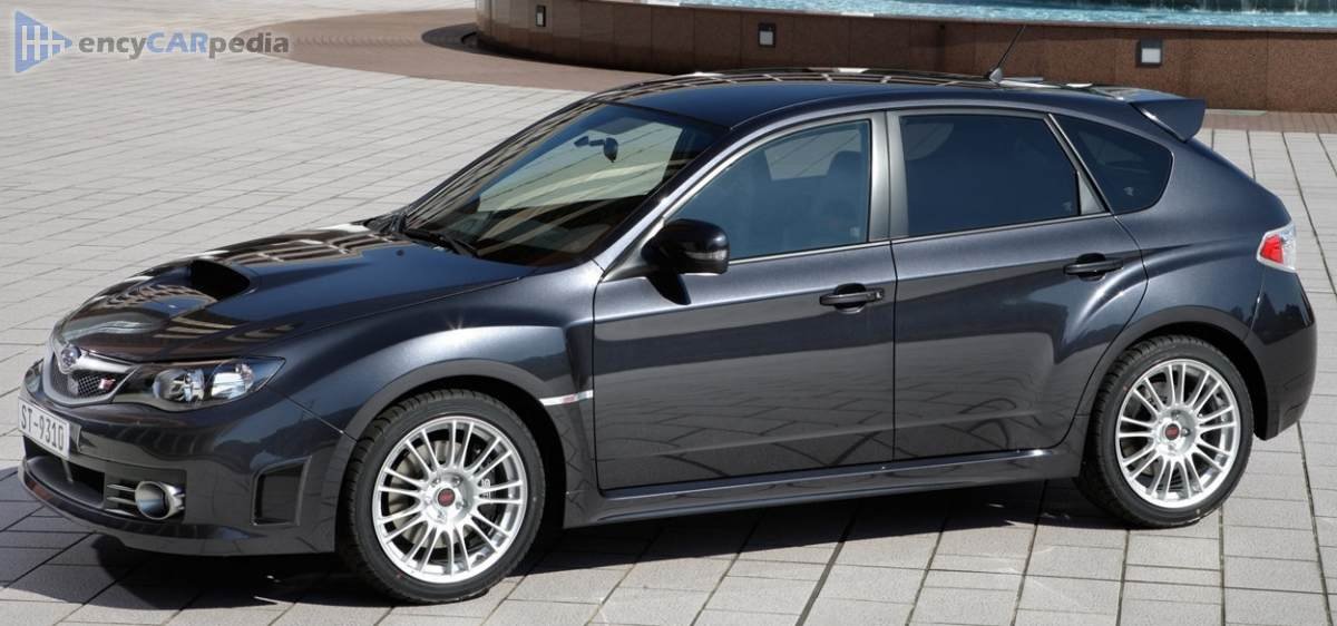

  10. Purchased a set of the optional STI BBS forged wheels to remedy one of the few I don’t like about the car. Also a bonus is less unsprung weight (apparently they are around 3kg lighter/wheel). **Images from the internet Will go from To
