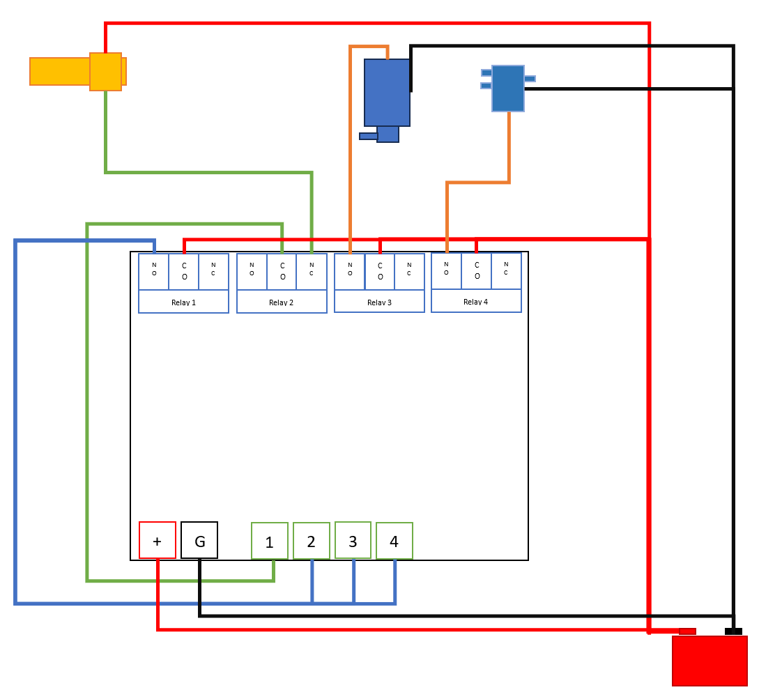

  23. MSword is slightly better than MSpaint Things in drawing are: Temperature switch, pump, solenoid. 4 Channel relay timer Battery Piping not shown I'd add: an indicator flasher relay between the solenoid and relay 4 NO connection for best efficiency and water savings. Also fuses should go between battery and relay common for relay 1,3,4 based on cable and device size. Heat-shrink and terminal fittings rather than bare wires etc Solenoid can either sit directly after pump and recirculate water back before pump or Sit between nozzles (or nozzle pairs if you run 4) so it alternates left/right or top/bottom for longer evaporation time
  24. Pump depends on the jets you use: windscreen or headlight washers are lower pressure mist and irrigation are higher pressure Hose needs to fit and hold pressure of: pump nozzles Tee pieces one way valve. Needed for washer and high flow irrigation nozzles. Irrigation no drip while not one way do the same.
