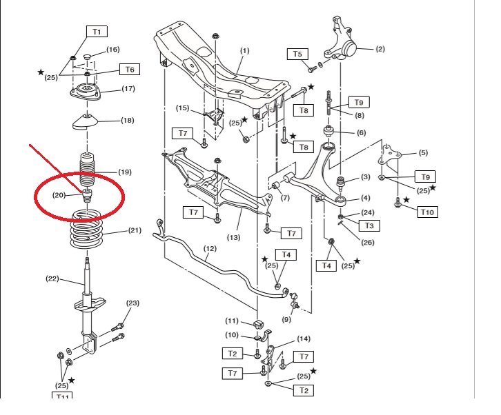

Hello All,
I have a question well a few questions really but we will start with the one in the title.  I have personal disassembly 3 different 2004 Legacy BLE Struts lately. Not one of them has had a helper?, are they even supposed to have one?. I can see the item on the general 2004/05 service manual number 21 but I have not bee successful finding a Japanese version . Or is it different for the Japanese versions?.
Any body think of a reason why they would have been taken out?, its not like its a premium part. If one was to put one in would it do more harm than good?.
Thank you for any input.
Thank you for the interest and the response. I have hopefully added the diagram of the front suspension and circled the item that is in question.
Yea that's a good point Boon. I have had the car over year now and driven around the North Islands fun roads. While doing so with passengers and there was no startling noises.
Although I am kinda curious to install it to see if I can feel if there is any difference to the behavior of the suspension.
Doesn't do anything unless you bottom out the strut. It just stops the strut bottoming out so hard; in theory your bump stops should be stopping the travel of the arms before the strut reaches the end of its travel. It's tapered to provide a progressive stop when you bottom out.
It's really, really hard to bottom out an unladen stock-height BP/BL, especially if it's on Bilsteins. I don't think I've ever managed it in our BPE, but then I don't drive it terribly hard.
