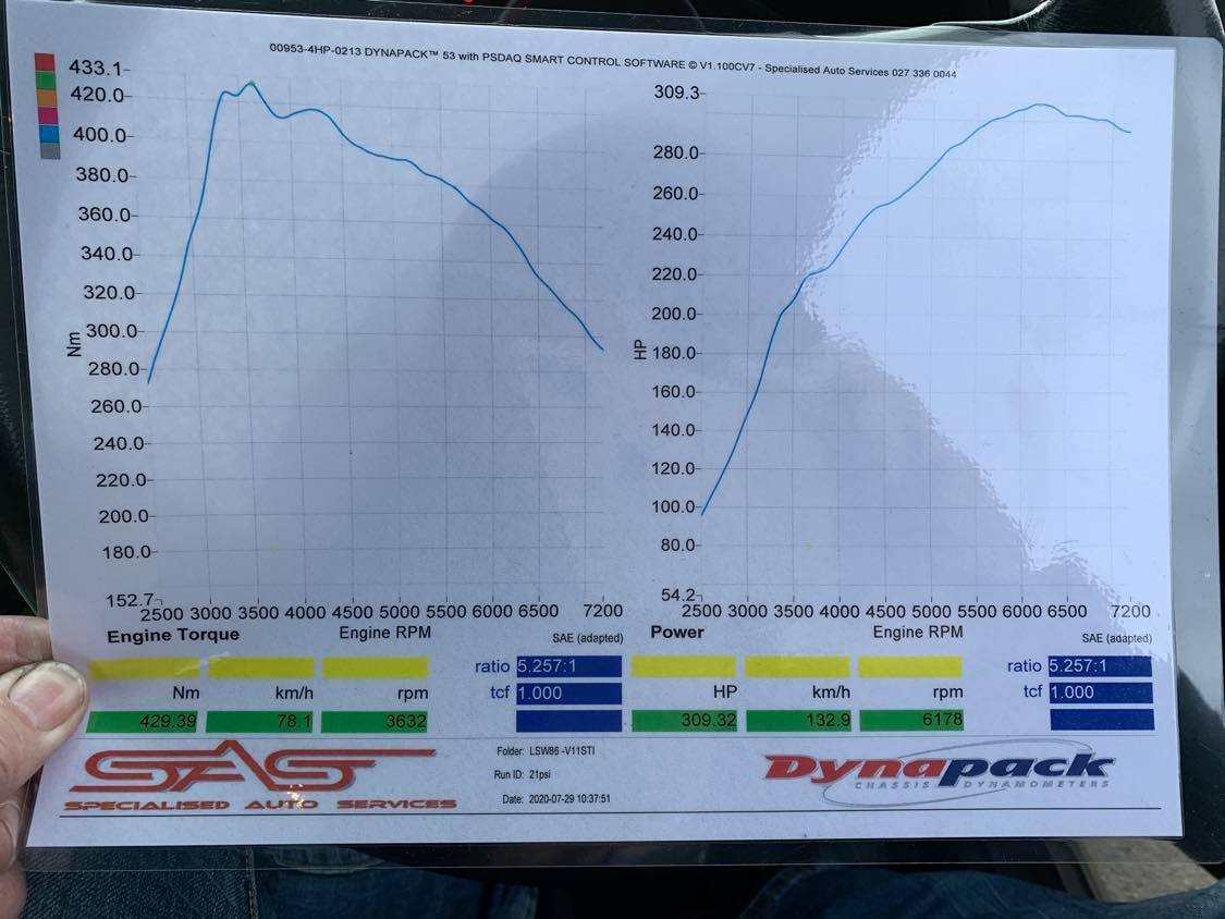

Tune is now done on the STI, 309.3HP, so bang on 230KW, the limitation being the injectors unsurprisingly at 95%. Graph is annoyingly in HP not KW, but close enough. DynoPak hub dyno at SAS in Christchurch Details: Jap import 2L STI 100 octane fuel Process West intake PBMS catless downpipe Invidia R400 exhaust Secondary air injection system removed Raceworks EFP-501 265Lph fuel pump 3 port BCS Facebook messenger quality video:

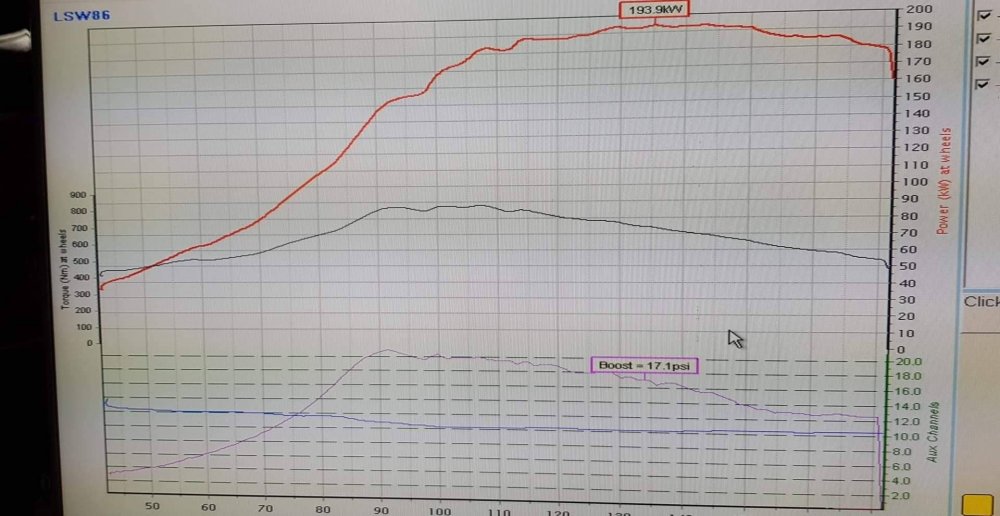

Ours (2.0L) is going in for a tune in two weeks, similar mods, but a little extra, Perrin 76mm intake, PBMS Catless downpipe, and an Invidia R400. It'll be tuned on 100 octane too, so will be interesting to see how it compares to yours. This will be tuned up in Christchurch at SAS. We had it dyno'd when it first came into the country at the end of 2018, here's the completely factory dyno sheet, with boost, you can see what @Gripless was talking about here:
