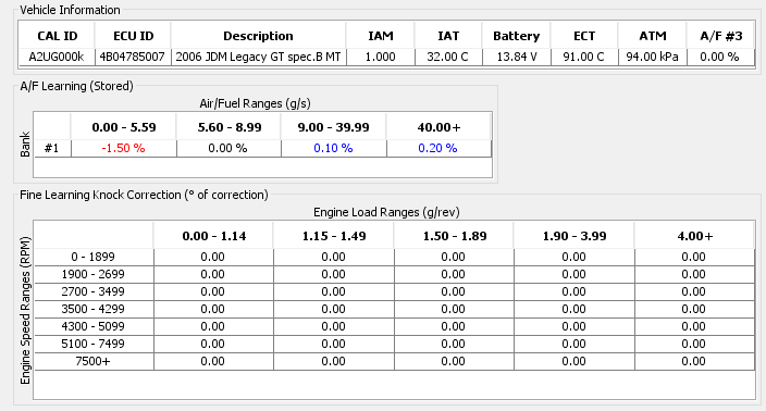

  1. Running on 100 now, reset the ECU and done a few short drives to get the IAM to move. Heres hoping it stays this way, time will tell
  2. ADM and JDM reading should be the same process. I use a cheap VAGCOM Ftdi cable which is just a cheap version of tactrix, but for logging only. I also used tactrix cable in the past and it works fine. Use rom raider software, make sure you download both ECU definition files, and also Logger definition files, and specify them in Romraider. Open the logger section, and then select learning view, after 5 or so seconds should pop up a new window with all the data. No need to bridge any pins, straight plug in and read data via romraider
  3. You were correct, I did find a small split in the air duct prior to the throttle body. Used some glue and filler to get it air tight back up. Somewhat of an improvement in the air flow figures, thats after an ECU reset and 1 hour of mixed driving and idling. Still baffles me with the IAM,

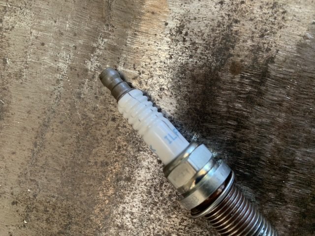

  13. So pulled the plugs and found the culprit. All the gaps were perfect, around 0.7mm ish. One plug had in fact a small hairline crack in it, which I can only assume happened during install, even though was very careful. Regardless I chucked an old plug in to test, and pulls like it used too. Ordered another and back on with the tune tomorrow once it arrives.
  14. Might have to pull them and check. First time I have done plugs so will learn for next time. Romraider reports no misfire, but it feels like it.
