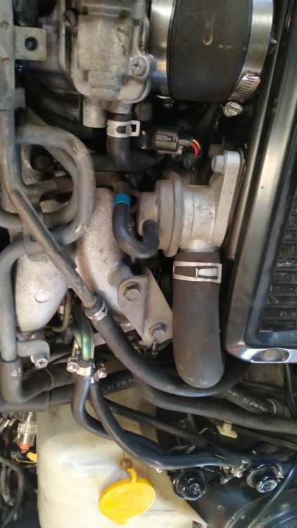

Does anyone have a concise diagram of the vac lines or even a engine bay picture that I can reference to mine to see if the plumbing is correct? Engine has been rebuilt by prev owner so not too sure if it was put back together right attached is a pic of the area I'm taking about (blue tee)

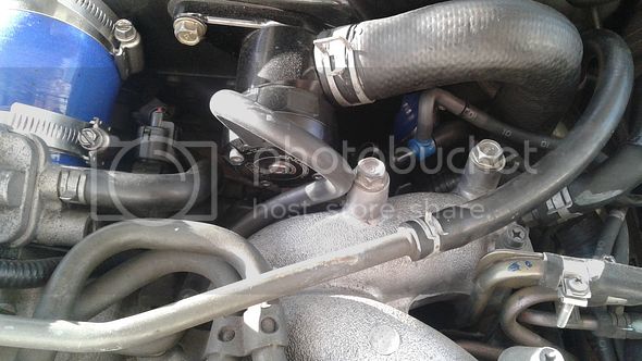

I know the earlier revs with the hose ten mod look like this attached pic but this d revision has no metal pipe ten but still has the strange blue tee not sure if that's normal and all google can show me with rev d engine bays is American non turbo ones

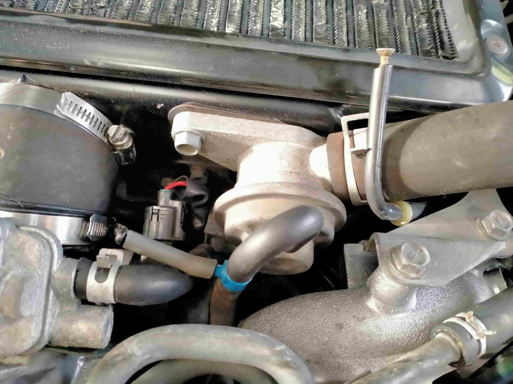

So someone has muddled up the vac hoses but I'm still very curious as to if this is a universal thing with the rev d or is it just my special case that's like this ?
See attached pic

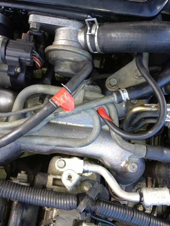

Again strange but found this on the forums hose 10 topic and this image has a very similar setup to what I've done
Straight hose to Mani from bov and obviously block the existing hose the tee came off of
