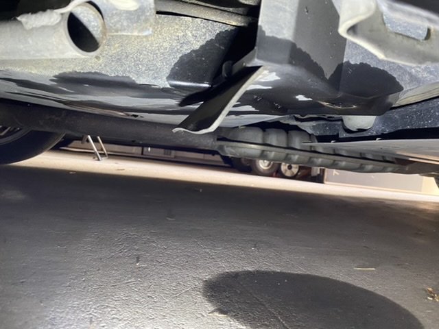

So I see and smell petrol dripping under my Legacy today, of all days 1 day before lockdown.
I had just filled the tank couple days ago.

Whip the rear seat base off and the little cover on the drivers side and you'll be able to see the problem. When mine was leaking it would leak down in that exact spot as it is right below the pump cradle
