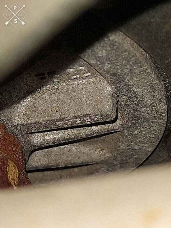

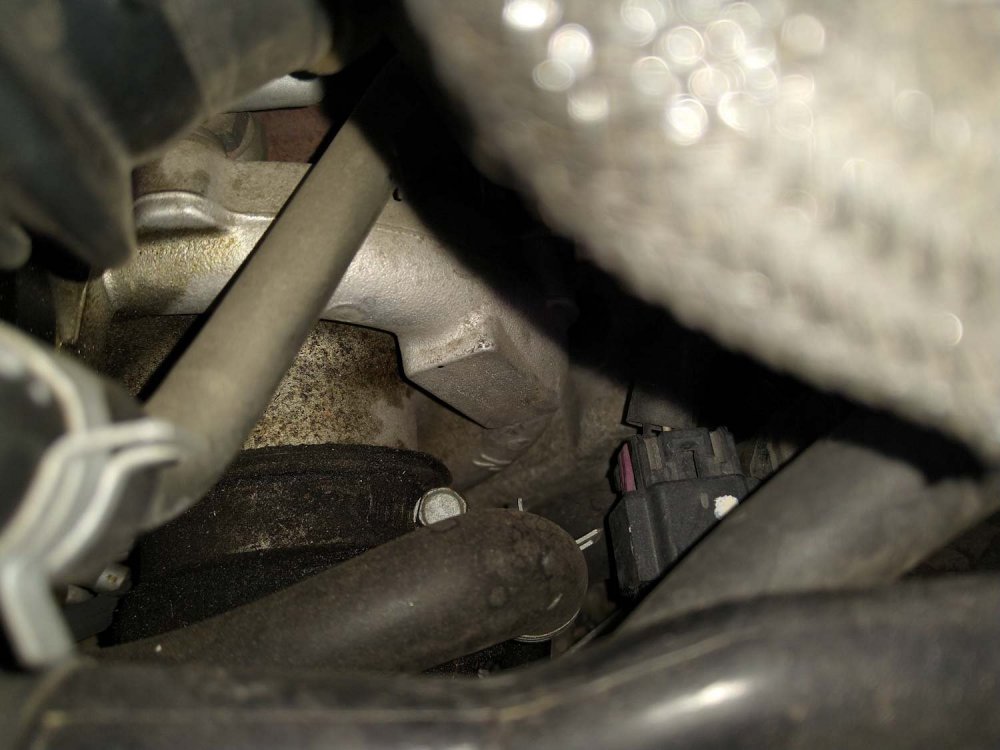

Hi guys, while your in the topic of Legacy turbo types... Can anyone identify this one in my 08 GT (auto) has nothing on the name plate area that i can see, but i can see a large N on front and f5 22 on the rear of housing? Is it a Vf45 also?
Another shot of rear
Edited by calibre
Try shine something brighter on that nameplate on the comp cover. It can be super hard to read at an angle like that sometimes. It looks like there might be some very light indentations on it.
Don't think so dude, this one is with camera pretty much directly in front of it

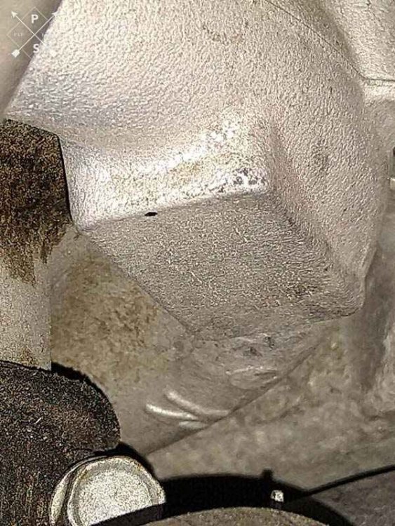

You'll be surprised at how hard those digits are to read when dirty and unless straight on. This is what mine looked like
