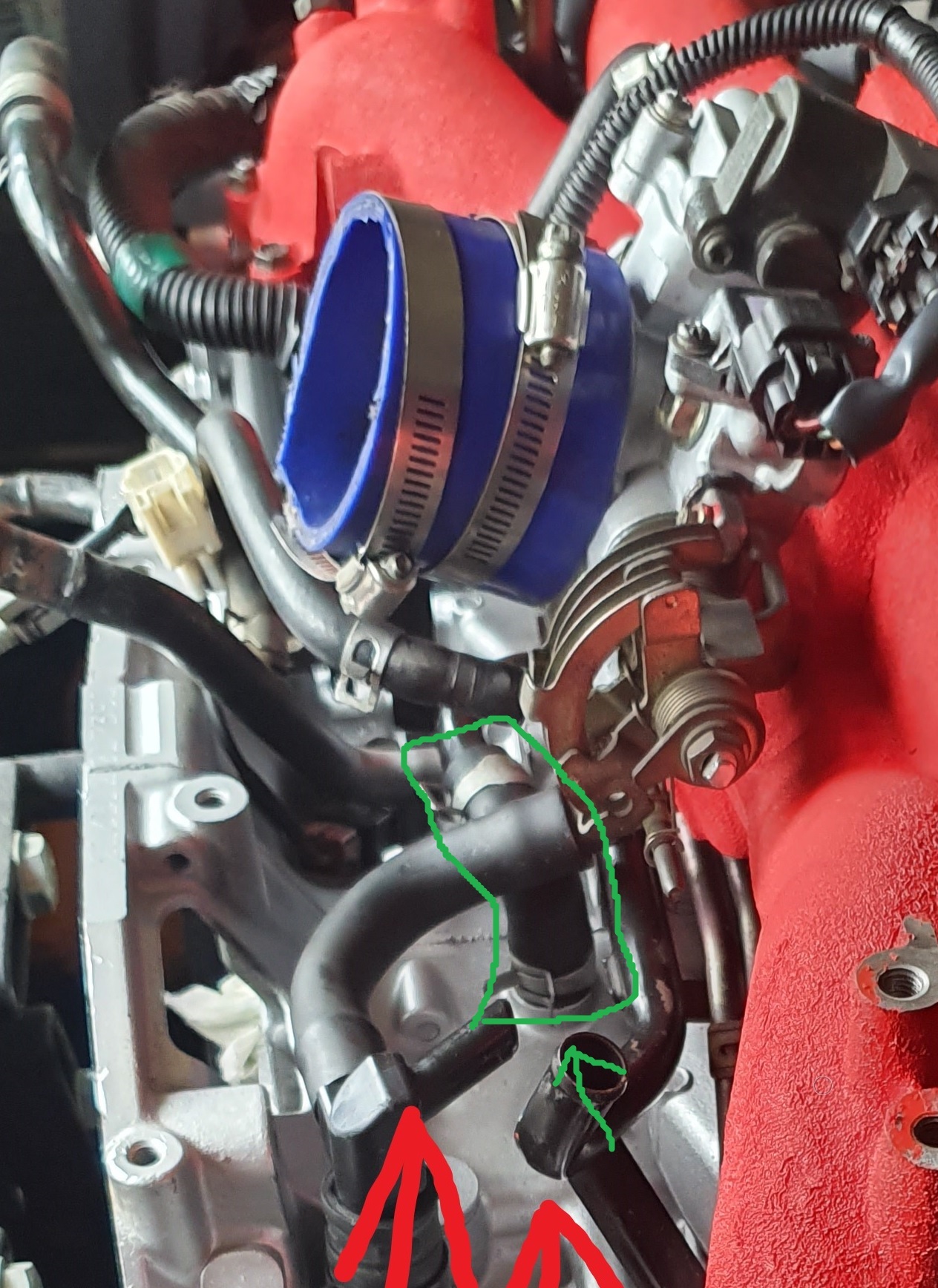

How did u get on? I had same issue on a v7 sti recently. I replaced some pcv hoses (pcv was rattling so that was fine) and it fixed it. The rubber was so brittle I had to cut the hose off. I think it was cracked and therefore leaking the vapors. It was the small 90 degree hose that connects from the block to the hardline that was causing it.

spray some degreaser on the oil patches, leave for a  couple mins then dry off with towel over the end of a screwdriver. After a drive you will see fresh oil if the leak is still there.
make sure to look at this hose in the green box, that one was my issue. Was rock hard and split. May not be your issue tho. Was a pain to change so only replace if u have to.
Awesome.  Thanks for the pic.  Much much cleaner than my engine ?
I replaced the hose assembly that the red arrow on the left points to.  Will get her all cleaned up and double check the other hose you’ve circled in green.
