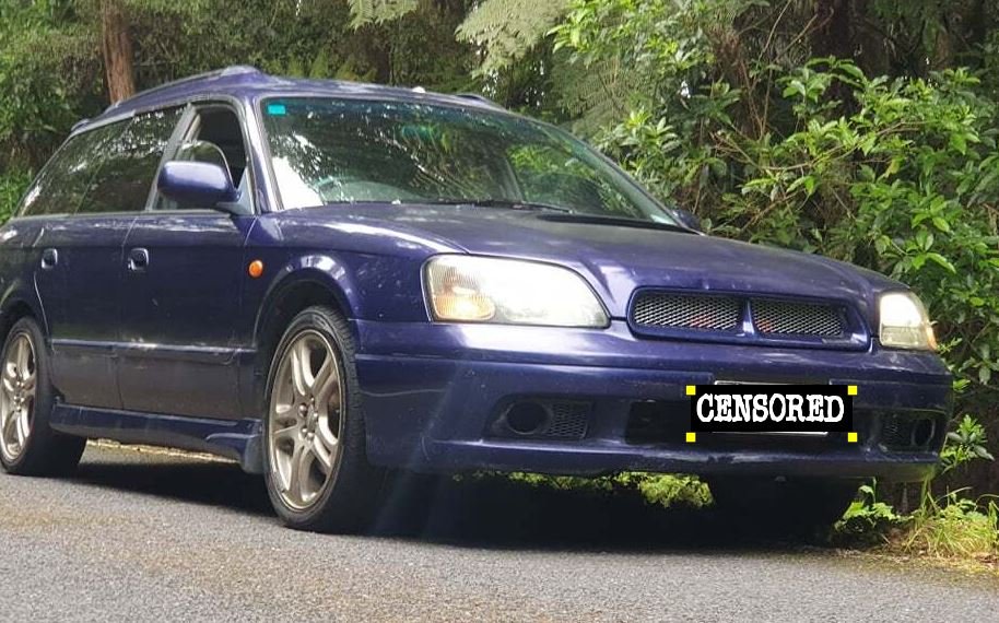

Hey Guys
Ive got a 1999 Subaru Legacy GTB (ej208), The car is built from 2 different cars with a lower km motor inside.
I got it for cheap  and it pretty rough, looking at some mods or tips on how to make this car fun but reliable and look the part
First turbo'd vehicle i have owned, and i do not know much about this motor, with all the vacuum and boost lines looks like fun
Ive heard changing the turbos is a good way to make these cars run nice
so far the on the list is:
Scarles Front mount intercooler kit and a GT2 600x280x76 intercooler
Gauges ( Boost, Oil Pressure, AFR)
Ideally some sort of Cold air intake
some nice 18x8 wheels and tyres
Full respray
maybe a body kit, RSK front bumper, or some lips of some sort?
New rear Garnish (As cracked and leaking water)
Foglights
Things i have done already is
HKS Turbo timer
Fluids Changed
Uniden immobilizer and alarm
Changed spark plugs ( Not the best to do )
RFRB Grille
 As I've said I'm fairly new to boosted Subaru's, so any advice would be great
Thanks
