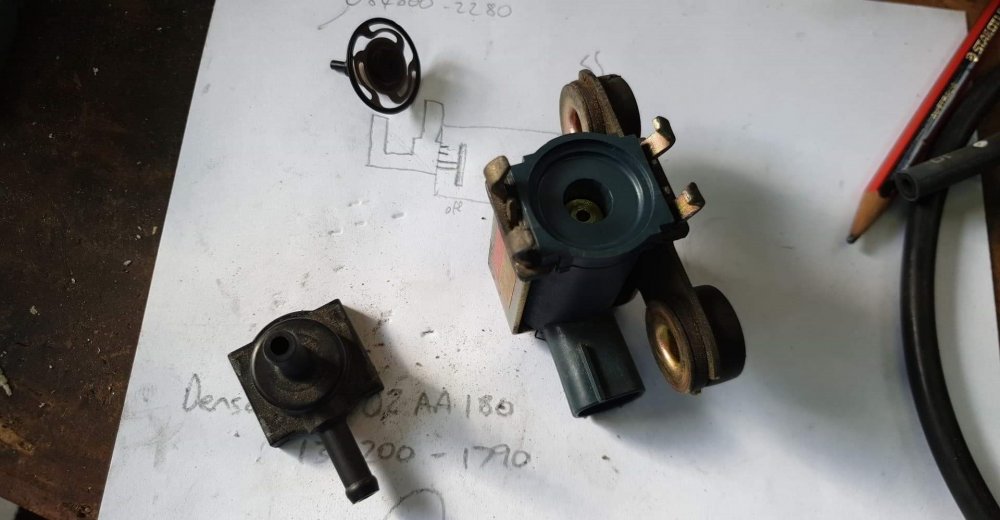

Problem fixed, the primary boost solenoid was stuck closed. I opened it up, looked like the plunger/seal got stuck to the port inside, and solenoid couldn't pull it back (open).
This is interesting, because the Exhaust Gas Control Valve Duty Solenoid (in BBOD) is the same type, and I had exactly the same problem after cleaning out the BBOD the first time. A day after flushing it through with CRC Carb Cleaner it got jammed shut. Had to open it up (pry back the metal tabs) and clean it again from the inside. After reassembling it worked ok again. I'm guessing the carb cleaner reacted a bit with the rubber seal inside and made it stick to the port inside.

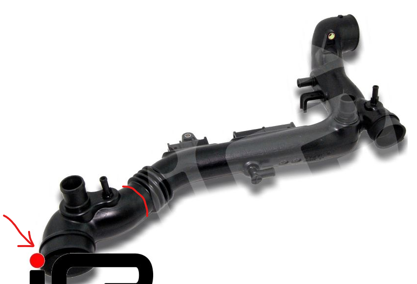

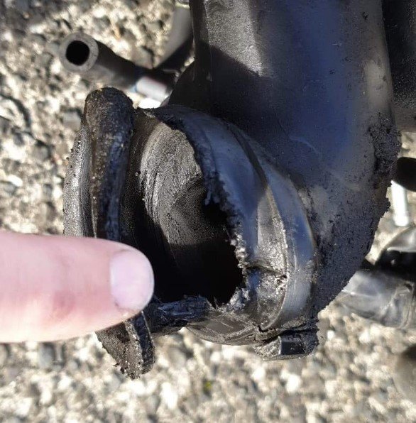

I inspected the pipe properly today, and it's rooted. All perished underneath the end rubber bit. Someone told me it's caused by oil (from crankcase breathing system) sitting inside the pipe, and the oil eats the rubber.
I'll definitely refer to this thread, the soldering iron smoke device sounds good ? if it's the gasket you can get by with rtv, I made my pipe work by taking it to supercheap and fitting together all sorts of rad hose, slipped over smaller hose, hose clamped together. That's because I needed it to work ASAP and a new replacement is like 200 nzd (ej20g wrx v1 mind you) though I should do a proper fix ASAP!
Yeah, I'm seriously considering doing a similar thing. If I can get a good condition used pipe, I might be able to cut mine off at the red line without having to remove the whole intake manifold/etc. Cut in same place on the new part, then find a metal pipe to fit inside as a sleeve, then hose clamp both sides down.
(red arrow is where the damage is)

51 minutes ago, Technikhaus said:
Damn that is stuffed!
Yeah, it's almost like its dissolved or something, only on the under-side. The replacement pipe I got has fairly thick rubber there.
I guy I talked to thought blow-by oil collects there, and over time eats the rubber. Makes sense, as I had a fair bit of oil in my intake and IC, and all over the top of the engine.
The big ol hose clamps wouldn't help. I'm going to replace with T-Bolt hose clamps, which should be gentler on the rubber.
