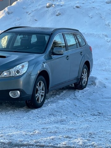

What I start with is this:
Click to view full size image
I have a 2013 BR Legacy.  Its a 2.5L NA.  Top of the line package with full leather, McIntosh/GPS, 5.1 speakers, eyesight.
My first Subaru and first legacy I've owned.
Every Legacy on the lot had the standard version stereo with the touch-to-open pouch under it.  Me wanting to have something different got this one.
Straight away, I realised the stereo and GPS system was technology from the mid 90s.  (I know cause I was driving back then)

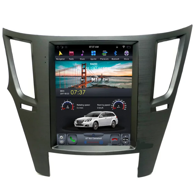

Then I found these on Ali Express.
It promises A LOT....Radio, USB, Bluetooth, Reverse Camera, OBD, Video (playstation/Go-Pro etc), GPS, Internet access.
ALL WITH PLUG AND PLAY.  COMES WITH ALL THE CONNECTIONS TO RETAIN FACTORY OPTIONS......mmm, yeah right..
Image result for 2014 subaru legacy stereo
This one is a CUSP brand.  But there's several different brands.  All of a much the same except different resolution and memory card size etc.
Its of course from China.  You might have your own ideas on Ali Express/Chinese products so lets leave those out and move on....

I then contacted CUSP and asked if they have a RHD version.  They said, "yes. sure".
Being wary of the price ($750 NZ) and my previous experiences of such retail agencies, I offered to send a photo.  I sent them a photo of my dash.
They reconfirmed, "yes this will fit your car perfectly."
So, I took the chance and sent the money, along with a "thanks.  And to confirm, I want a black version...Right hand drive".
It arrived quick, like 5 days.  Black.  And LEFT HAND DRIVE.  I knew this was too good to be true.
I emailed them straight back.  She told me that this is the only version they have and they sell them all over the world.  They suit any model car.
Anyone can see that its not symmetrical.  I relayed again that she was wrong.  I understand I'm in the minority here in NZ having a RHD car, but these do NOT suit every model.
She reconfirmed that I was worried about nothing and just needed to send it to an expert for installation.  She had spoken to her experts and again told me that these were interchangeable between left and right hand drive.  I'm not sure if their intellect is low or they believe mine is?.  Either way, I wasn't going to get far.
If I wanted to, I could send it back at my cost.  Maybe $100 or so.  Then I'm stuck back at stage 1, hating my 90's stereo.
Having done several ICE installs before, and a typical kiwi that refuses to believe things can't be done, I decided to just have a go.
