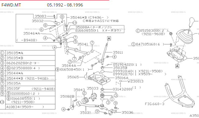

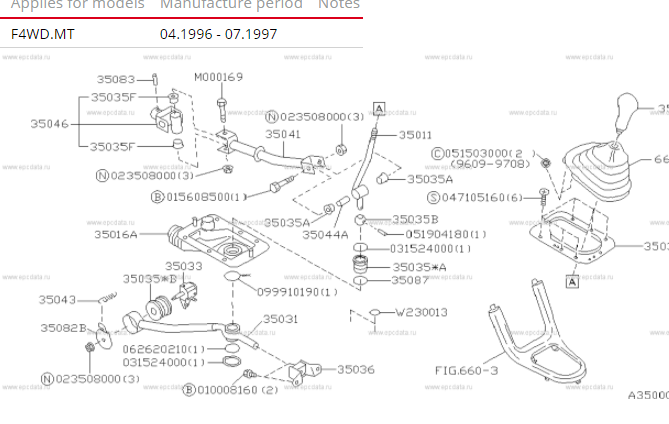

Just thought I'd update this with some info I've found, as I'm putting a newer setup in mine since the newer joint is easy to get (PN: 35047AC030).
Subaru changed the shift linkages around 1996/1997.
Running a couple of Chassis Codes in Amayama I found the images of the two.
You can swap between the two styles, but you need the entire shift assembly; the Joint, rod, and selector:
< 1996:
>= 1997:
