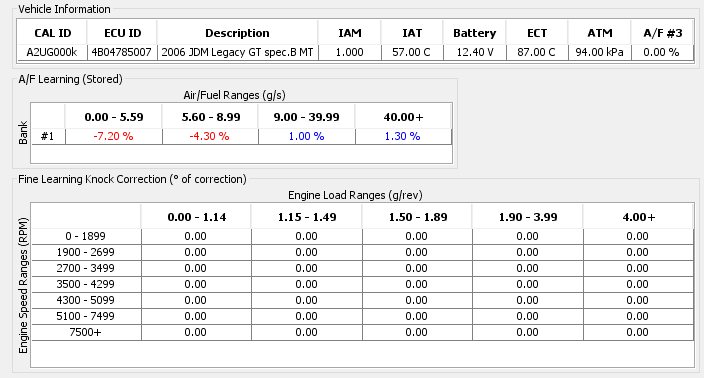

Finally got Rom Raiders LV to work. Before doing the work, my fuel trim highest was -13.5. After doing the work, dropped to 9.5-10.8.
Why the fueling numbers are out are still so negative are beyond me. Maybe my next task is to pull the turbo off, and while I am there get the banjo bolt filter out.
Out of curiosity, when doing logging, what data value should I be using (4 byte or 2 byte etc). When selecting both, give slightly different values.

Have you got the stock intake still? Those figures would indicate either you have a decent air leak, aftermarket intake or MAF/O2 sensor problem.
2 and 4 byte should give very similar data. The only downside to using 4 is it uses more data so if you use a few 4 byte parameters you’ll find the read speed will drop significantly so data points will slide further out of sync with each other
He can tune it for you, you just need to flash a different ROM to the ECU first as it is the same one as mine. There is an 07 ROM available that worked perfectly for me once I finally got round to flashing it.
Yes everything is still stock. Have replaced both the MAF and O2 sensor before, boost leak test done by Crowesport etc. Had replaced the fuel injectors, redone the intake manifold seals, change intercooler. Nothing fixed, last we decided was just to tune it to see if it goes away. After all the work I did, it did drop from 15 to 13 and recently to 9-11 range.

But with regards to the fueling issue with negative trims, check out the 2 logs below. They both show the car at idle after a short drive, starts at -10, and while sitting there drops down to -5 range, then after a short drive around the driveway creeps upto -8. They tend to be all over the place.
https://drive.google.com/open?id=1QAp-LFdftk-EgqxnqcAdxJpWRznpNiMX
https://drive.google.com/open?id=1jhO4ItHK2TCMIL_74REzZEpaynWz7CXU
Before that I made a smoke machine to recheck for intake leak, nothing, as the boost leak test showed as well.
I have just started the tuning process with Dave and awaiting his first Map to be sent.
Edited by logan25
