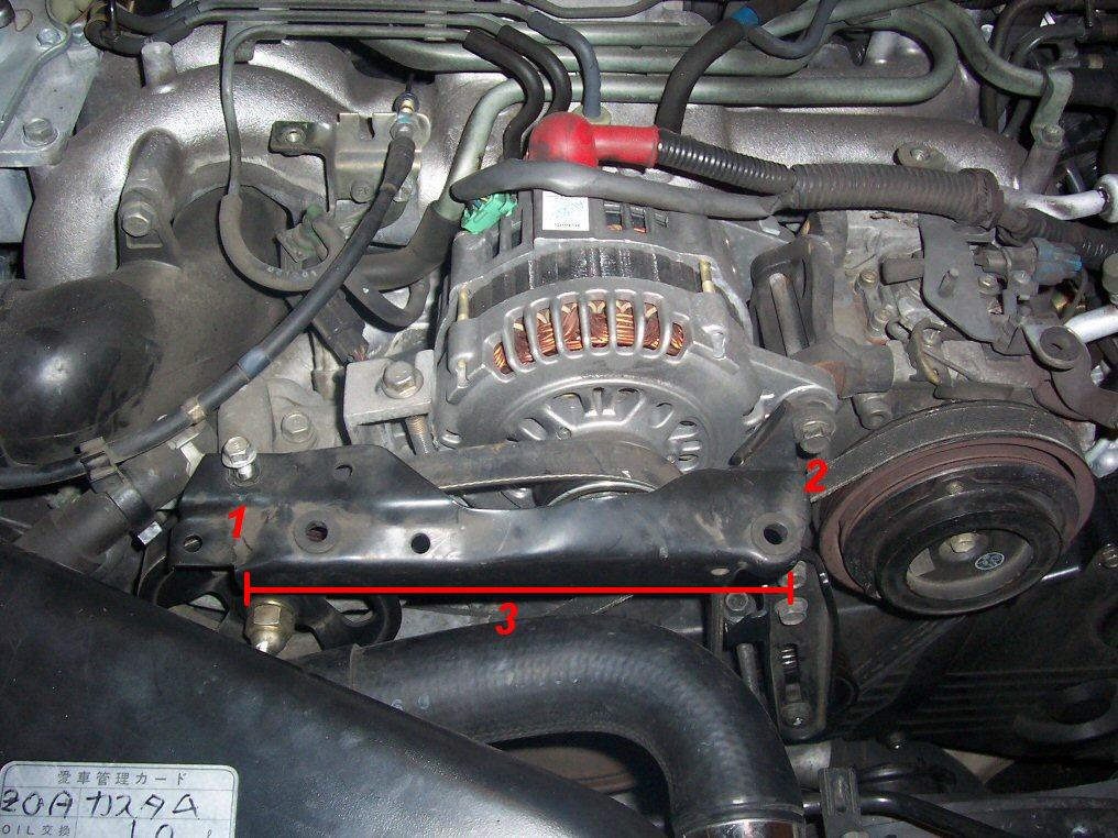

Step 1: Remove the plastic cover.
Step 2: Remove bolt #1
Step 3: Loosen bolt #2
Step 4: The black metal bracing, #3, can now be removed. In the next picture you'll see I simply rotated this out of the way, it was only afterward that I saw that bolt #2 fits through a notch in this bar, rather than an actual hole.

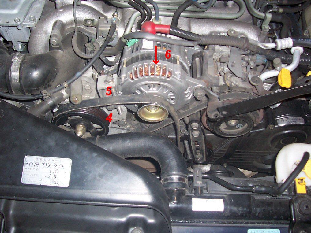

Step 5: Loosen bolt #4
Step 6: Loosen bolt #5 all the way, as you loosen this bolt your alternator will lower. If it doesn't, press down on the alternator, #6.
You will now have your alternator lowered all the way, the drive belt will be loose and you can simply remove it and fit the replacement. Repeat the previous steps in reverse order.
Yay, you're done. Such an easy job.
