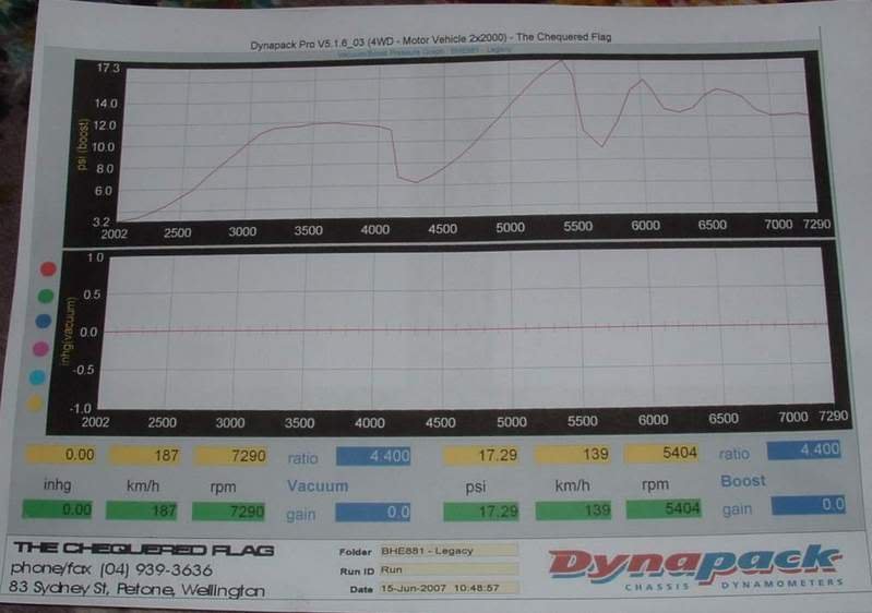

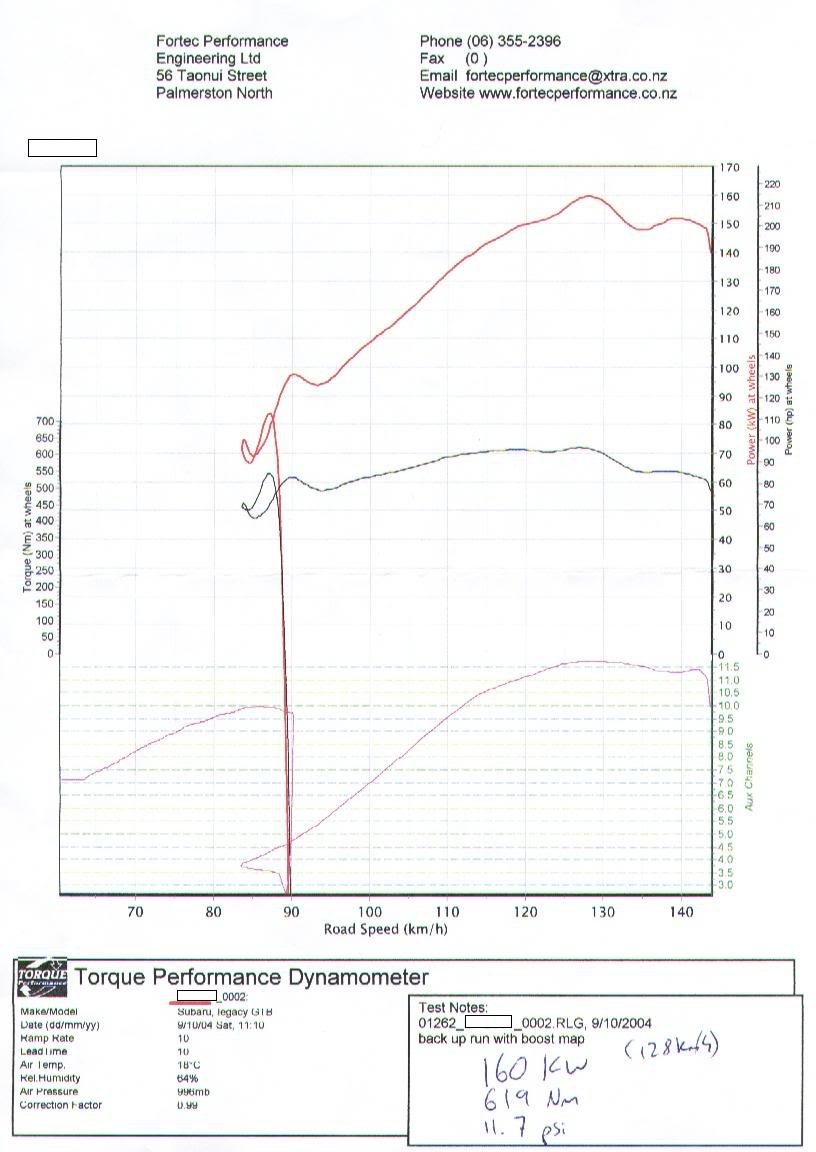

This is one of the earliest Dyno Sheets of my TT (the 1998 BG5c) = 160kw
bonus actual video of the Rolling Road setup & run on a Digital Camera with no Mic
October 2004 not long after I traded in the 1990 BC GT for it
Sorry no RPM's but a notable dip in power / torque : No-ones been able to explain the funky backwards lines but I think you can see the VOD there on the PSI chart

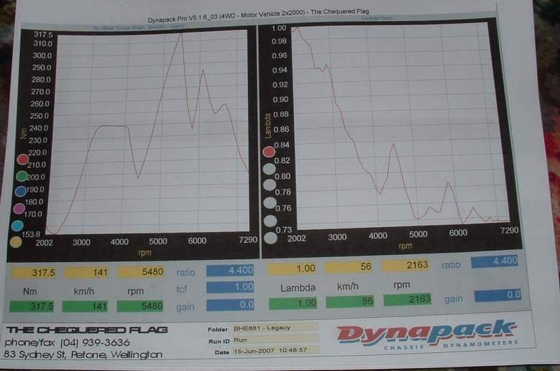

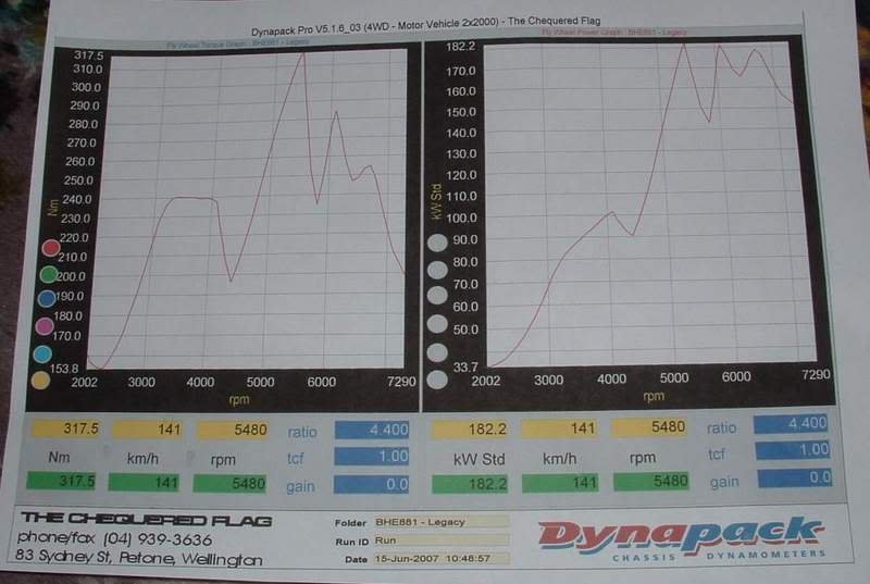

2007 Hub-dyno Petone
I call it 180 kw WITH Boost Spike : split 4mm or 6mm hoses on the top of the intake

@Joker No-ones been able to explain the funky backwards lines but I think you can see the VOD there on the PSI chart.
The plot X axis is road speed and the line from data logged over time plotted in time order, so the run started at 90kph then dipped back to 85kph
likely caused by operator error, you can rule out car if you have other good plots.
-Wheelspin from not being strapped down well. 1 strap and not at steep angle rushed at dyno day. Or too much power applied too quickly.
-starting run and not giving it more gas so dyno load drags speed down.
