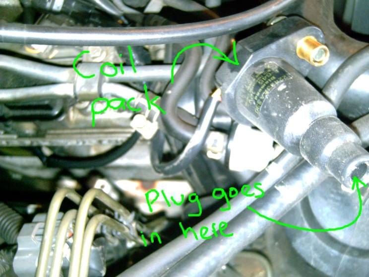

5. For the rest of the snaps I'm going to use the passenger side as an example. You can see in this image the 2x coil packs sitting in the heads. These are fairly new (at the time) coils so they aren't a dirty poo-brown colour yet.

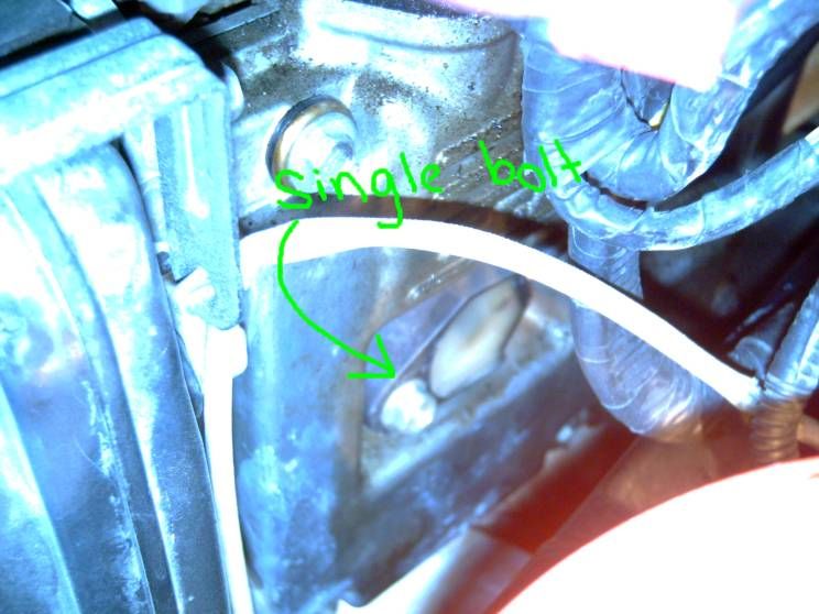

6. You can see here a single bolt that holds the coilpack in. From memory it's a 12mm bolt, and due to space restrictions I tend to use a spanner rather than a socket to undo it.

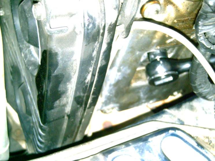

8. So here's our gaping plughole with the plug sitting in it still. Thankfully someone bought me a socket set with a sparkplug socket and flexible connector so the task of getting the bugger out wont be that hard. It is tight for room though, so woman pleasing fingers are key.
Here you can see my socket working it's magic on the hole. It's fairly easy to get the socket on the plug, just make sure it's on there right before you start unscrewing it. Because of the limited room to move the socket you should either get a smaller one (my socket is huge), or unscrew it to a point where you can just use your hands and the plug-socket to undo it the rest of the way by hand.

13. Once the plug is nicely back in it's hole the interesting job of putting the coil back in is upon us. It's a bit of an art I think, but this is how I do it. I put the coilpack in the hole but not all of the way. Then I force the coilpack to the top of the plughole and push it in further until it stops as the bottom of the rubber sheath bit bangs in to the spark plug electrode. Then I slowly move the coil downwards while pushing in, and usually the electrode slips in to the coilpack and slides up as I push. You'll know if you've got it in right as the coil pack will slide right in to the head. If you've ****ed it up then the coil pack will hang out quite some way and the bolt wont go in.
