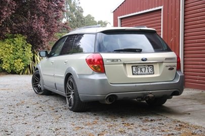

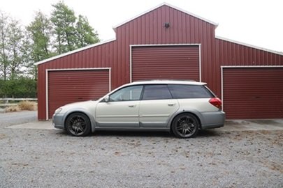

Inspired by all the great looking Outback's, I had to have a go myself.
Full Legacy swap, with struts/springs front and rear, lower front control arm rear stud and backing plate,  rear trailing arm spacer, steering knuckle, and removed front and rear subframe spacers.
Unfortunately the pick-a-part rear struts are totally shagged, so i'll need to replace those, but otherwise dives and handles a treat.
Sitting on TBC Jet 18x8.5 45p with 225x40x18 pilot sport 5's.  I would have preferred 35p offset, but got them second hand for a good price, so can't complain.
