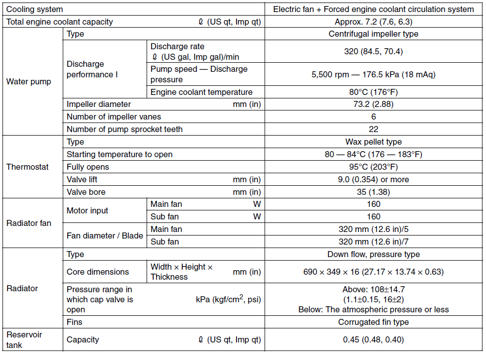

What temperature should it run at? What temperature should the thermostat open?

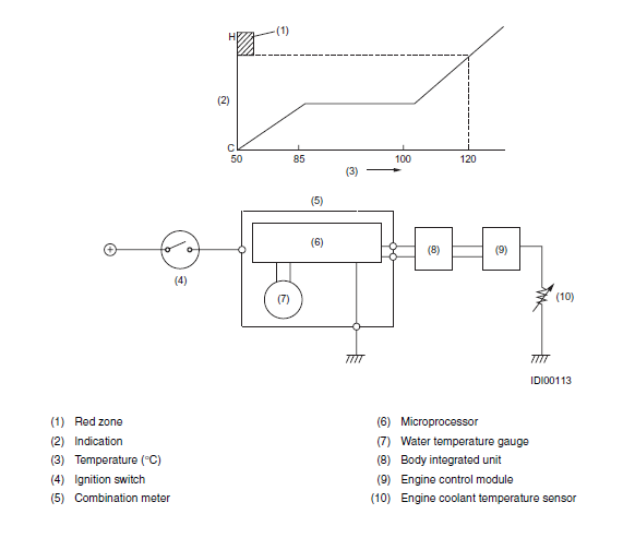

With our cars the thermostat is fully open @ 95C, couple of images from the factory service manual below. Seems the dashboard temp gauge specs are horizontal approx' 88C to 102C.  Normal temp is a good question as there's not much log data shared online for the 3.0's but after reading around my guess (and it is just that) perhaps around 90C to 96C for Auckland with the dash gauge one tick below the horizontal. Maybe plus a few C for heat soak at traffic lights.  Plenty of people report that the dash gauge can clock-face 9 up to 11 so right up to the 110's with hills, hot weather or towing but I guess each car would be slightly different. It would be great if other H6 owners had data to share on this.
I don't reckon small spikes of temperate are critical especially when it's managed back down but when my radiator developed a small leak the amount of time the temps basked in the 99 or 100C range increased more and more.
h6-cooling-dash-gauge.png.f6dc5611355caa49e1448e218cb8271b.pngh6-cooling-specification.png.2e4a124e3b68809bcebdedb511c4221e.png
My temperature gauge sits slightly below horizontal, about where it's always been. Might give it a new thermostat and radiator cap anyway, the cap looks original so 13 years old. And a flush and new coolant. Won't hurt it.

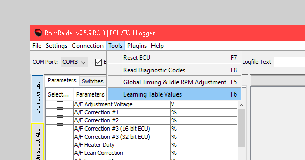

yeah true they are real lethargic immediately after reset.  you can get LV by pressing F6 or the Tools menu whilst connected to the vehicle
I just tried to do the LV log as above, but it came up
" ECU definition file not found or undefined. Learning Table Values cannot be properly retrieved until an ECU definition is defined in the Editor's Definition Manager"
So ( in plain English ? ) how do I do that?
Just means that your cars ECU ID isn't in RomRaider's default defs, not unusual for the 3.0's.  From your first post BtSSM screenshot it's D2UH001T - we can add this to RR;
