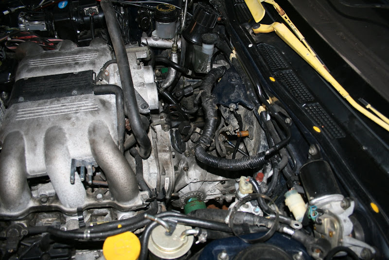

well the engine is in the hole and mated to the 5 speed,
came up against a few issues but we will sort them
drivers side exhaust will have to be modified (bloody cross member in the way)
and we still not sure wot we gonna do about the radiator it may end up having no aircon ?
and bonnet wont close completely but we will try the legacy alternator mounts and see if it lower....
new fly wheel fitted...
will it fit :)
damn looks like the gearbox needs to come out again
would that be a gnats hair clearance
Well that answers that question an eg33 does fit :) :) :)
plenty room back here
dont think a radiator will fit here(yet)
we are considering getting a NA bonnet and VZ badging should make for a pretty damn good sleeper
we were pleasantly surprised that the ride height seems to have remained the same
