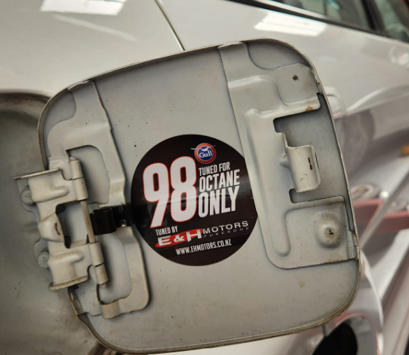

E&H Motors Pukekohe
Important note.. unfortunately Gull Force 10 is being removed from a lot of the Gull stations. This fuel was by far the best pump gas and any cars we have tuned to run on Gull Force 10 98 octane only will need the tune checked and most likely some ignition timing removed. If your car was tuned to run on Gull as well as Mobil and BP 98 you will be fine. Please call us at work if you are unsure if this will effect your car.
Thank you, team E&H Motors
From a Facebook Post this week
