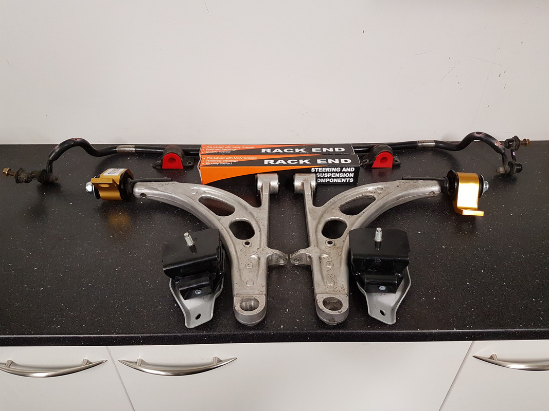

I got all the parts I need to do the Sedan conversion on the front.
I have new Sedan rack ends, Alloy arms, new whiteline bushes/anti lift kit and sedan sway bar/links.
Do I need to use an inner rack end remover tool or can I just use some locking pliers (forgot the name). Do I need new rubber boots/washers or anything like that?
Sway bar I just need to remove the sub frame and a plate in the middle afaik. Then tighten everything with front wheels on ground.
Control arms should be easy enough.
Might also install my group N engine mounts as I might have better access bolts and things with no subframe, sway bar, control arm or rack ends in the way.
I'll also install new brake pads at same time. Cant wait untill its all done. Should be interesting after its all done and aligned :)
Any tips would be handy.
Edit: still need to install my rocker cover gasket set too....
What does that kit exactly do? I'm curious about specifics.
Bend back the locking washer first (will need a big flat-head screw driver or chisel for this) first. Then a big spanner (the open end) if you have the right size will work. Locking pliers (or water pump pliers or poly-grips) should work fine. If you have access to the proper tool, I would use it.
There should be new locking washers on the new rack ends. If not, reuse the old ones. Or use some Loctite (use the stronger mid-strength stuff - I've seen drifting people use red super strength and wreck steering racks by doing that).
Shouldn't need new boots, unless they're torn in anyway. Just cut the ties holding them on. A decent cable tie will work fine for holding them on (it's what most workshops do these days).
You can get generic ones you cut the ends to fit your rack etc from Repco/SuperCheap if you want new ones.
Im not the guy to talk to about this. Basically the control arms from sedan gives a wider track width as wagons have non alloy control arms which are shorter. I assume its ligher too. A few people have done it here and they can explain better im sure. Whiteline anti lift kit is not nessesary but i needed new bushes anyway so I decided to get it.
Yep just checked, they do come with locking washers. Thanks for info
Get the new set of boots anyway. Better to swap them now than have worn ones.  Plus sometimes they are worn enough that the tear when sliding them back.
what are you using to fix the camber issues?
Depending on the width increase extending the slot on the shocks can work, or camber plates up top.

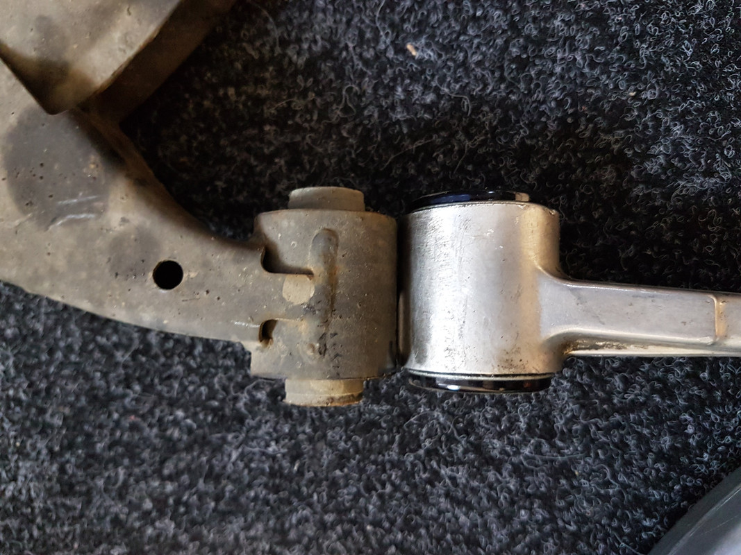

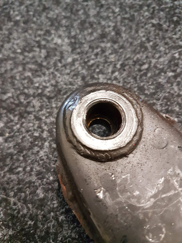

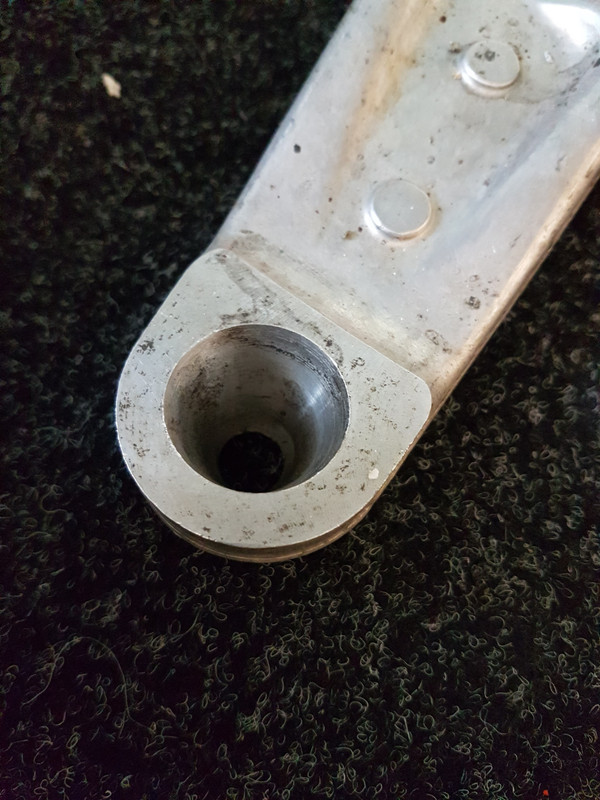

Uhh just realized that my alloy control arm doesn't have the small bush for the ball joint. The arm that came out appears to have something there.
@IZichard how did you get around this one..
Old arm:
New arm:
There's no getting around it, you need pn 20216FA000
Just now, Subru said:
okay, damn I knew there would be one thing...
haha yep i got caught out on the same thing ¬¬ see if Subaru have them in stock (assume $$$ tho) otherwise get them in from partsouq/whatever you like
Kinda want it done today so im just gonna give Subaru a call and see what they got. Will places like Bnt have stuff like this?
Edit: Rang Bnt and they didn't seem to have anything. Only have 1 in New Zealand from Subaru so have brought 2 off partsouq which will take 3-4 days.
