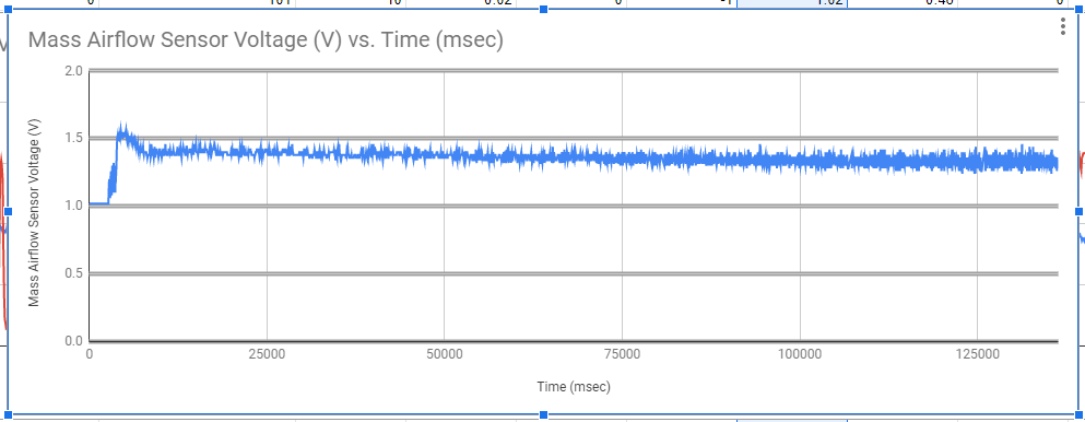

Yeah, that's why I logged data from the ECU. I seemed to be getting realistic data from the MAF sensor, but keen to hear your opinion.
Here is MAF data on cold idle:

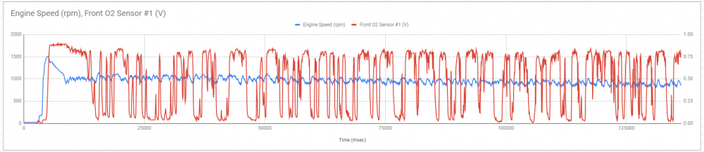

And here is the O2 sensor & RPM. It's all over the place, and shows the idle speed flapping around too.
I logged heaps of data, but it's hard to show all on one graph. Let me know if you want to see any other data.

What exactly is wrong with the idle? looks stable to me.
rpm fluctuates (like a misfires every second or so), and hesitations when accelerating or coasting from idle up to 0psi. On boost it appears to be ok.
