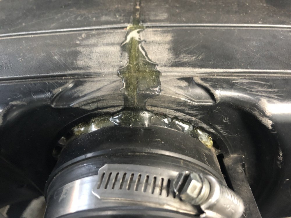

That timing is down eh, either BtSSM is reading IAM wrong or there's a fair bit of real or perceived knock which explains the lack of drive-ability.  I see you've already checked for loose parts that could make a metallic ringing including the cat shields.  Any corrosion or cracks on the knock sensors themselves? Does you car have an EGR valve under the intake passenger side ? Much residue/clag around the injectors (would have to remove the black fuel rail protectors ) ?  Also the serpentine belt tensioner and idle pulley are a weak point on our engines and can chatter before failing.
My intake had a similar split that filled well after sanding with JB Plasti Weld (Repco) and an opp' to check throttle body is clean.  Catalogue codes show Subaru made a later revision to the intake but these are expensive.
I think the  BtSsm is reading the IAM correctly, as there is always a long list of knock events on the tab next to the "LV" at the top right of the screen. I might get some of those off and post up so you can see. It doesn't look right to me, as they are quite often as low revs or low load yet it reckons it is pinging it's head off. As far as I can tell and hear, there are not rattles of loose things, either at idle with the bonnet up, or driving along with the window down trying to hear anything. So I really don't know.

The thing I've noticed when I had the Nexus in the car and could see the IAM live, when it's sitting at whatever number, any time I drove the car any harder than absolute grandma, even if I drive the car just totally normally ( not giving it any beans but not taking all day either ), the IAM always took a massive dive instantly. As you can see on tonight's log, the IAM is at 0.000. What happens if it wants to take even more timing out? Can it go negative? Or does it just display 0.000 and then keep taking timing out anyway if it wants to?
IAM 0.0 is the ECU needing more data to make up it's mind but somethings definitely wrong here, as you know!  FLKC protects the engine up to 7 or 8 degrees which did get touched on albeit spiked very briefly.  Could be so many things but airflow is interesting.  After you let off the pedal the  throttle closes appropriately but it's taking three or four seconds for the mass airflow reading to reduce.
- is that intake chamber crack fixed ?
- the pipe between the the air filter and intake chamber has a tab that must line up on the chamber kinda underneath and towards the driver
- the pipe on the air filter box & where the chamber hooks onto the throttle body has rubber ends which can get kinked or tear causing leaks ?
- is the MAF sensor dirty, loose or wiring damaged ?
- is the MAP sensor (front of intake manifold) loose and have it's small rubber hoses to the filter connected  (should be able to blow air gently thru filter & hoses)
- are the 2 knock sensors (under the intake manifold, blue connectors) loose or corroded, cabling ok ?
- any loose debris rattling around under the intake manifold ?
- any gunk around the fuel injector seals ?
- the orange gaskets under each side of the manifold and on the throttle body have tabs do they look perished ?
- is the throttle body clean ? (added with edit)
So I finally found the time ( and a spare car to use ) last night so I pulled the air chamber off the car and put some Araldite in the crevice where the crack is. Should be able to put it back on the car tonight.
The pipe that goes between the air filter and the chamber, the locating tab wasn't really lined up the best so I'll make sure that is right when I put it back together.
Everything else looks ok in terms of nothing seems loose or wiring damaged etc. I haven't cleaned the throttle body, and not sure what condition it's in, might have a look tonight before I put the intake chamber back on.

Firstly, I sealed the cracked intake box the day I picked up the car. With regular maintenance I've been cleaning the throttle plate for carbon build up.
After your suggestion, I checked all header/cat heat shields for security and found a couple brackets loose and vibrating. New bolts and/or nuts secured those. Small improvement to engine running seemingly felt.
More recently I replaced all spark plugs with NGK ILFR6B plugs. When doing this I came across 2 further issues. Removing the headers to jack up each side of the engine revealed a loose header nut causing an exhaust leak, couldn't hear it at all though. Cleaned up all surfaces and seems to be okay
Secondly, someone previously has broken some of the locking tabs off the coil wiring plugs. Their solution was to fill the surrounding area of the plug with RTV, now rendering the plug useless. This also seems to be causing the plug to not be seated 100% of the way home on the coil. Whether this is causing irregular coil performance I don't know...
After fixing the exhaust leak, new plugs and an ECU reset the engine performance feels like it is improving further. Again I don't have the data to prove it, though it certainly pulls harder and smoother, more consistently as well
