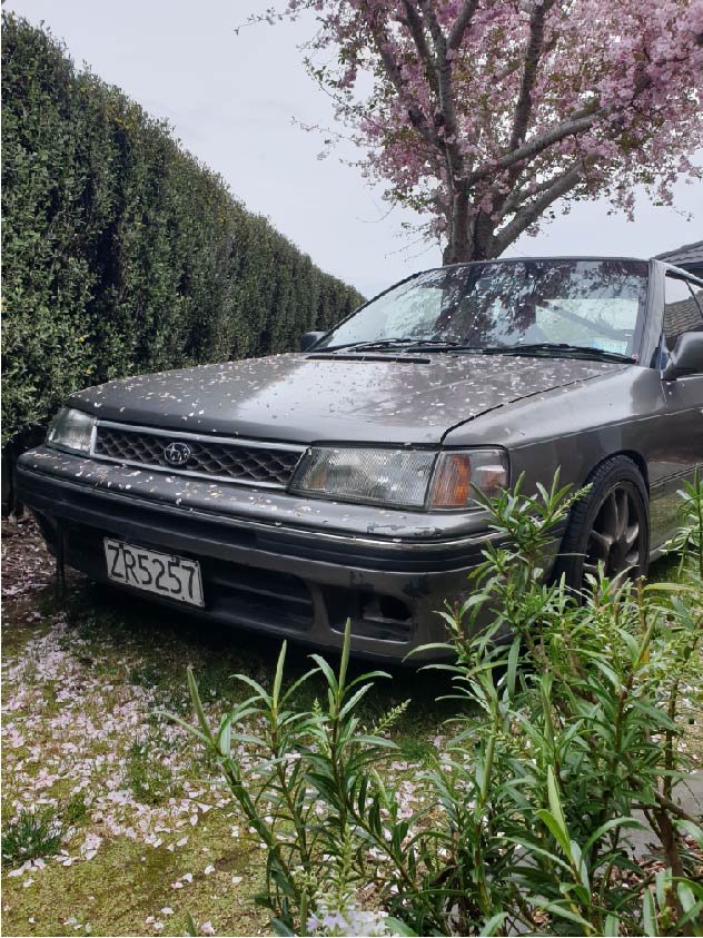

Hey Guys
First time posting, long time Subaru owner.
I've got a 1989 BC5, which I have spent the last 2 and half years building with the intention of being a street legal drifter. Due to lockdowns (and life) I haven't been able to take it to a track day and so it just sits in the garden no being used. I really want to get out and enjoy the car especially after spending 2 years, and a stack of cash, sorting it out.
I have done some of my own research and I know the basics of certs, adjusties, power, seats etc, but I find the LVVTA website difficult to understand. I need advice more around RWD conversions, steering set up and general welding rules. I have kept the car pretty basic with the aim of seat time over time in the shed. I have also  included a full list of specs and mods below. "???" for mods i am unsure about.
Are there any cert guru's out there that have done something like this before and could tell me if I'm dreaming, or is it possible without costing my a fortune??
1989 legacy VZ - shell has current rego (on hold) and cert but certed for EZ30 and adjusties.
V4 STI EJ20K - completely stock
Link plug in ECU @ 195kw
V4 STI gear box - welded center diff - ???
Drive shaft loops
Tein adjusties
STI 4pot front brakes
30mm front spacers
Redrilled front knuckles - ???
Spaced alloy lower arms
2.5" turbo back exhaust with Apexi rear muffler
V4 STI strut brace
BC5 RS steering wheel
NZKW bucket seats
4 point harnesses - still have factory seat belts
Home seat rails - ???
Rear half cage - ??? (welded by a fabricator not me)
Welded BH5 rear diff - Obviously needs to be removed for cert.
Stripped rear interior and boot lining.
RS front and rear bumper and bonnet - yes, im that guy.
Apologies - Lots of info!
ANY ADVICE IS GREATLY APPRECIATED. I just want to drive the bloody thing!

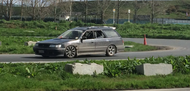

this guy wen with RX7 parts apparently (though I am unsure of current legality status)
[searching for facebook or IG link now)
%7BfileStore.core_Attachment%7Dmonthly_2021_11/image.png.a8b5d5e5b386ba4ba2557985d2491879.png
@boon @Joker yep drift car things, if you redrill (and reamed to correct taper) the track rod pick up point about 20mm-ish inwards towards the hub you can pick up a noticeable amount of steering lock, nothing too crazy but definitely helpful when sideways. I assumed so, they help on the track but I still have some spare untouched knuckles for the road.
That BF is owned by a guy called Wes, he has FabicationWorx in Tuakau, he's using FC rx7 front knuckles, which pick up even more lock than redrilled subaru knuckles, he has even made his own nissan rear end conversion kit (diff and hub carriers). The wagon isn't currently legal, I think its just waiting until he has the time to get it done. He actually welded my cage for me, really great guy.
