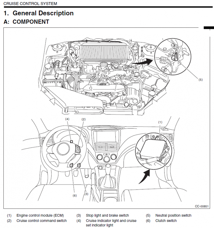

There's a component diagram page 2983 of the '11 STI Factory Service Manual do your cars have the neutral or clutch sensor switches ? Diagram should be attached

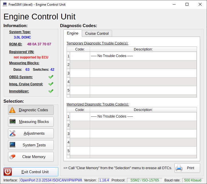

As far as I am aware, for a simple plug and play deal you can use FreeSSM to check whether Cruise Control has been integrated into the PCM. I have an '05 BPE Manual, Import, without cruise buttons/switches fitted, though the computer indicates it has been pre-programmed (by the green tick) and would only need the necessary hardware to 'activate' the system

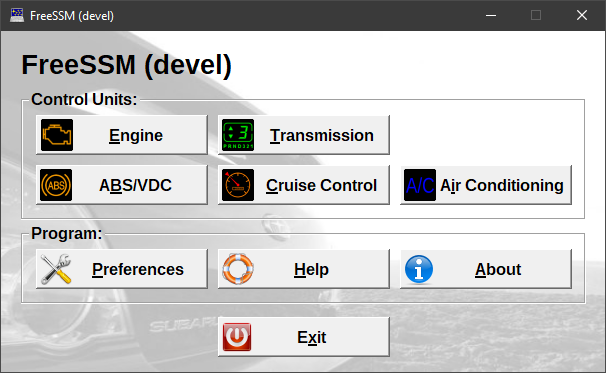

The dev edition of FreeSSM now works with Tactrix OpenPort 2.0 and shows ECU CC info on my '07 3.0R.  Not sure if it will talk to newer cars such as your '11 but might be worth a go as you have Tactrix.
