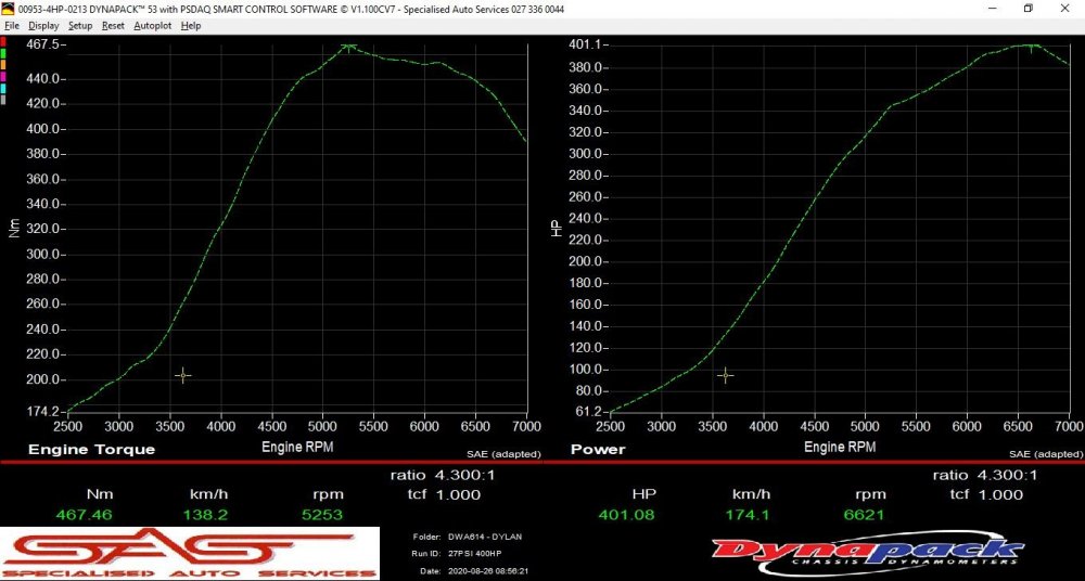

Big fan of this vehicle. It's a tidy gc8 with v7 drive train. Mods being simple for power. Forged 2l motor with standard v7 sti heads. Sti twin scroll with vf36. Factory v7 sti top mount and g4 running the show with flex fuel to e85. Id1000 injectors which are maxed out with a dw200 pump.  Custom built SAS intake and exhaust.
This is what I call value for money power. 228wkw on 98 and 275wkw on ethanol. I think that's about the most you can get out of a factory top mount and turbo haha.

2.1l stroker, id1000 98 fuel, EFR7670 20psi as ran out of map sensor. 272 cams. Hks single scroll headers and 0.84 housing. Makes more power and torque than last setup everywhere and that was a TD05-20g and 2l
  • Like 6
Just a valve grind and cams I'm told as we didn't build this one. V3-4 heads so no avcs. Injectors are id1000 and at 75% with a base pressure of 45psi. Yours should spool far earlier as your running avcs and another 0.4l capacity.
wow, if you upped the fuel pressure would you reckon theres room for e85 and bit more boost pressure to push that thing further? or around there is the limit of id1000s?
Hmmm i too have ID1000s but was hoping on them getting me to 350wkw. At 75% duty cycle, your getting 4kw per 1% duty (i have no confidence this math is correct lol), so could i assumed +60 kw at 90% duty cycle (15% x 4kw) ? @gotasuby
hmm this assumes there is a linear relationship between injector duty cycle and wheel power output. i would have assumed the higher up you go in the power range, the richer you need to run the fuelling so you get less and less returns per injector dc% ?

1000cc fuel injectors will usually get 300wkw on 45psi base and good fuel pump capacity but that's usually there limit
Good to know. Just checked a few old logs and I'd guess mine are slightly undersized for my goals. 880cc making 280kw @75% with the help of water/meth
