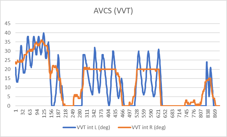

IAM 0.5 means the ECU is recently reset, IAM 0.0 means it is building up data to work with but 0.062 is real low.  The first thing to look at is your AVCS aka VVT as the left hand side is very erratic and would definitely cause probs,  should be a graph attached.  There are further AVCS diagnosis parameters that can help I'll find a list of those (edit: any labelled OCV or oil control valve).  Any new check engine codes, oil leaks or noises on the engine passenger side ?
Wow this is interesting!!!!!
BTSSM doesn't have the OCV parameters so need to test them against AVCS angles using RomRaider.
Or pull the solenoids out, swap sides and see if the issue stays on the same side or moves with the solenoid.

Regardless, left and right aren't doing the same thing which is concerning. If you have a laptop and RomRaider already installed then that is the easy option.
