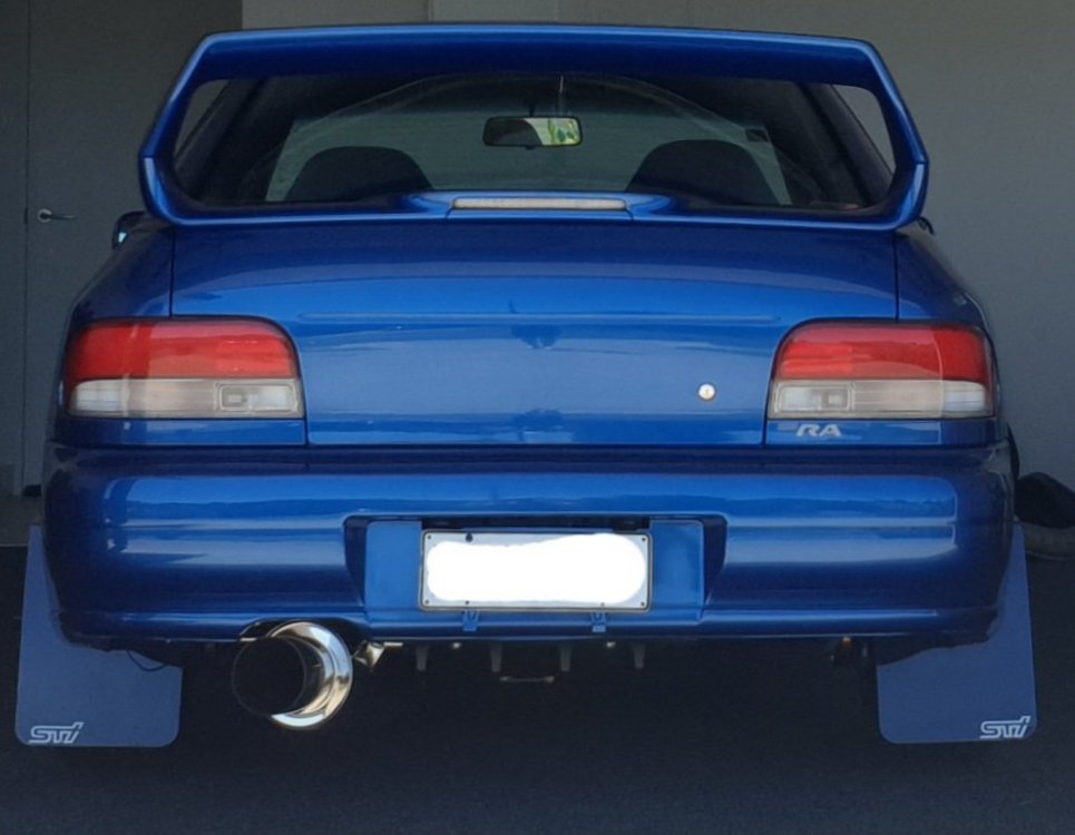

I have noticed one scrape on the centre resonator. However I am getting some group N exhaust hangers to see if that helps lift it a bit.
I am pretty fixed on staying 3inch the whole way through now.  And needs to be stainless. The problem i have, is the HKS sounds very nice, and works well, and I already have it, however its just the the more look at it the more im not sure about how it looks. You can see the whole rear muffler hanging out the bottom of the car and it just looks a bit wrong. If the exhaust had 2 x  90 degree bends at the muffler so that it sat straight and high like a stock muffler it would look fine. The 4.5inch tip is just HUGE! ?
I am leaning towards getting a custom Cat back made with an adrenalinR muffler hidden up behind the rear bumper and then a 3inch stainless pipe bent in an S shape and coming out nicely out from just below the bumper.
Kind of like this  https://www.haywardandscott.com/subaru/impreza-classic/subaru-impreza-classic-group-a-replica-3-rear-silencer.html
Or this factory look would be nice too. https://www.haywardandscott.com/subaru/impreza-classic/subaru-classic-3-backbox.html
It gets expensive getting stuff like this from the UK. Pity we don't have many people doing this type of thing for these older cars over here.
Bro that exhaust looks mad! Mine comes out on an angle now and I love it! I can see literally most of the muffler and it just looks aggressive and wicked.
Honestly bro I would not change your exhaust it looks bloody awesome!
Edited by Bugeye01WRX
It is very JDM however I've never been a huge fan of big bore exhausts. The only reason I bought it was because it was the only bolt on readily available 3 inch system available at the time for a reasonable price. I didn't even consider custom at that time.
As I have got older and the car gets older I think either OEM look or rally car style look suits the GC8 best.
I suppose that bumper cutout doesn't really support dual tips all that well. Something like Niran has done on his but only on one side with a big Adrenalin resonator/muffler and twin tips straight off it suits older cars quite well and is a bit less in your face big.

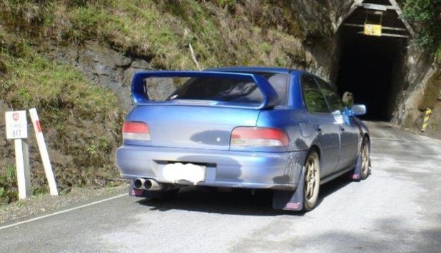

I did have a 2.5inch Remus exhaust on it with twin tips before I fitted the HKS system.
I still have the Remus exhaust so could always go back to that. I am only making 230kw so surely 2.5inch is big enough to support that power??
Here is a pic with the Remus from a few years ago before I did the restoration. Still quite like that look.
Edited by ginganinja
I wonder if I just modify the Remus muffler and cut the 2.5inch pipe off it right at the muffler and then run 3 inch pipe work right the way up to it.
Yea I like that look way more. Keeps everything way up tighter to the car than a massive cannon. Surely you can make it work again somehow.
