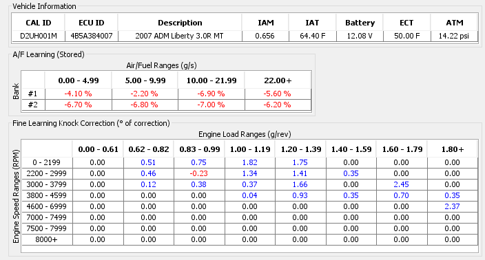

Finally ordered a obd2 cable to look at its data, and found the LV data below.
My main concern is the IAM value, also have the negative air flow values which I will try track down any leaks.
Just seeing if this is someone normal for the EZ30 engine here using NZ fuel, I am currently using 95, may have to consider 100, what do others use here? I used 100 in my previous GT, which got the IAM upto 1.0, do these EZ30 need it as well? Or is that IAM value normal for an untuned EZ30?

Through leak check is the way to go if it still has the factory MAF box and not a pod filter one. Those figures are reasonably bad so it could be the infamous split in the intake plenum just before the throttle body

All zero’s in those two tables means the tune and health of things is bang on but usually isn't attainable for a stock tune so a little bit of variation isn't terrible.
The corrections in the top table can be controlled by the ecu as high as 15% so they're half way to being uncontrollable variations.
Most of your bottom ones are positive which isn't super normal but isn't bad like negatives are which indicate there has been knock in that range consistent enough for the ecu to make a semi permanent reduction to the timing.

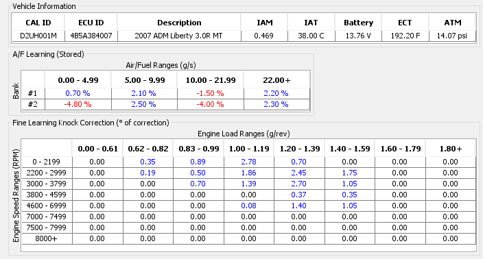

You were correct, I did find a small split in the air duct prior to the throttle body. Used some glue and filler to get it air tight back up.
Somewhat of an improvement in the air flow figures, thats after an ECU reset and 1 hour of mixed driving and idling.
Still baffles me with the IAM,

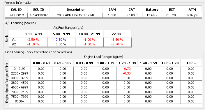

Running on 100 now, reset the ECU and done a few short drives to get the IAM to move.
Heres hoping it stays this way, time will tell
