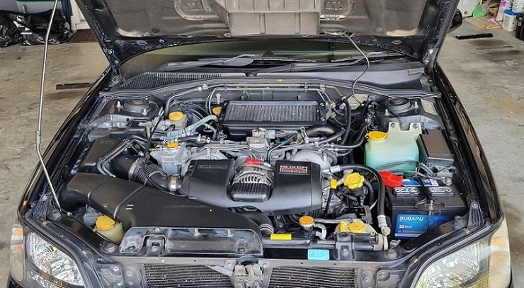

Replaced the A/C compressor in the RSK, too hot in Florida to go without...
Then cleaned her up...
Then shuffled the all Subie's around the garage...
  • Like 4
