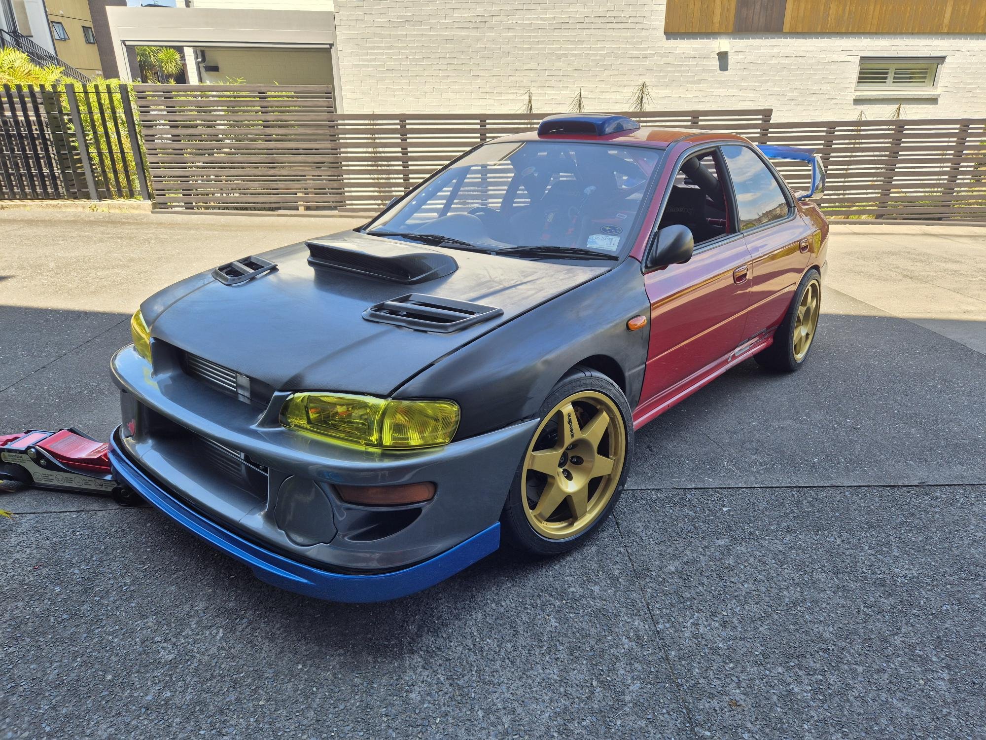

Found more rust, again tiny. The rails have been rubbing and made little 2mm circle of missing paint.
Got bored/brave and cleared up all the rusted stone chips around the car. So scratched rust and treated, primed all ready for painting.
Tested roof sound deadening and it’s just quieter to notice, but not a big improvement. Though other than rain noise I think will be back when factory headliner goes back in since it is far more reflective than the foam.
The heat insulation on the other hand is obvious. With a window cracked it doesn’t increase in temp anymore. The outside is too hot to hold your hand on but inside is warm but not hot.
The downside is when parked in underground where it’s cold, the car is still same hot temp when you get back. Even when roof was cold the car stays insulated.
I did figure out the roof rib bracing gets to about the same temperature as the roof skin. Roof ribs now has thermal tape of fibreglass and alloy like exhaust wrap but super thin.
At 100kph the roof skin cools down from 70-80 degrees to more like 40 degrees. So didn’t need AC running on motorway.
All this is still without the headliner which should add more insulation.

Headliner back in, just need to tape A pillar wires back to the holders
Lost one bolt somewhere along the way. They were all screwed back in but some fell out when driving. Turns out they are all cage nut from datacenter phone sized, so easy to replace.
Painting went well, no spills or runs. Even colour matched well. Did the stone chips and roof gouge all with reasonable success.
Will give it 24 hours to cure then still the roof rails back on.
Car all back in one piece.
The roof rail clips all worked fine, but they really do need the 2 little tabs to prevent any movement. The tabs were missing from all but 1 clip when I took them off.
I found a couple in among the plant matter under the rails, but seems they get brittle and fall off.

Added eyelids to headlights.
Noticed when doing indicator bulbs the top of the lens was getting a bit worn. Looks like a mix of sun and dust blasted stripping off the top layer of polycarbonate.
Will add a door foam tape weather seal above headlights to seal to bonnet to stop the air travelling along top of lens in future.
Minor updates test fitted the headlight covers, awaiting last of the parts to land then off to panel & paint.....Finally

Finally cut out big hole in fenders behind the front wheel vents for more air flow.
Just used a nibbler for the bulk and Dremel to finish and round the edges. One side is primed and painted in matched colour the other side is waiting on more parking space to dremel and paint.
https://www.jaycar.co.nz/nibbling-tool/p/TH1768
other people have done this ages ago. The 5 hole idea works and is far quicker but the lowest hole won’t flow as the plastic cover gets in the way. Better to enlarge the bigger factory oval than make the lowest hole…
https://www.iwsti.com/threads/fender-rear-engine-vent-optimizing-performance.191959/page-8?post_id=3207454#post-3207454
edit…
the most important thing when making holes or cutout other than don’t cut the chassis and wiring is…
leave the 5-10mm around any bend or crease in the metal so it has some strength left.

Too much happened today so only managed to get second coat of priming done at 1am.
edit..
all painted and just waiting on some new panel clips and the replacement sti badges.
