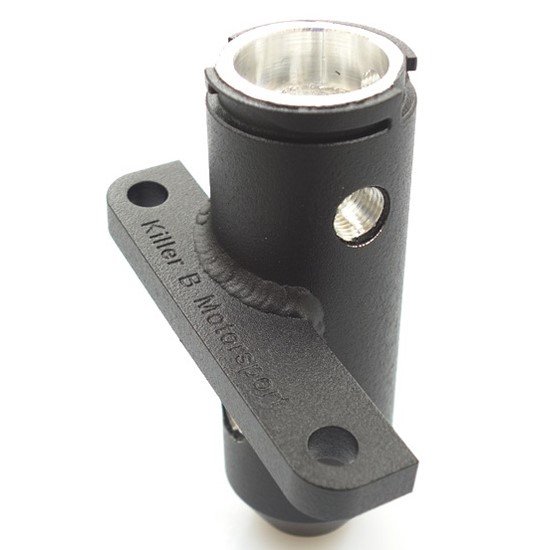

After idling the car up to temperature in the car park with the bonnet open the intake on turbo side was hot while the other side was barely warm. Say 70c vs 30c between sides.
Given the hood was open and hadn’t been making boost the turbo wasn’t very hot leads me to suspect the coolant top tank since that would be at 90c according to the coolant temp sensor.
The tank is a killer b one so all alloy and the mount is a 6mm heavy plate bolted to the manifold so it transfers heat well compared to old thin steel or newer plastic ones.
https://www.killerbmotorsport.net/shop/utcrv2an-b-upper-turbo-coolant-reservoir-v2-with-an-fittings-631
image_1024
added some thermal washers above and below mounting plate and Heatsink to the top threads of the bolt. Total cost around $10

Found slow leak in killer B upper reservoir from the side L fitting between the intake runners. There was a 5mm little stalactite from the dried drips underneath. But that explains the sweet smell in the engine bay.
