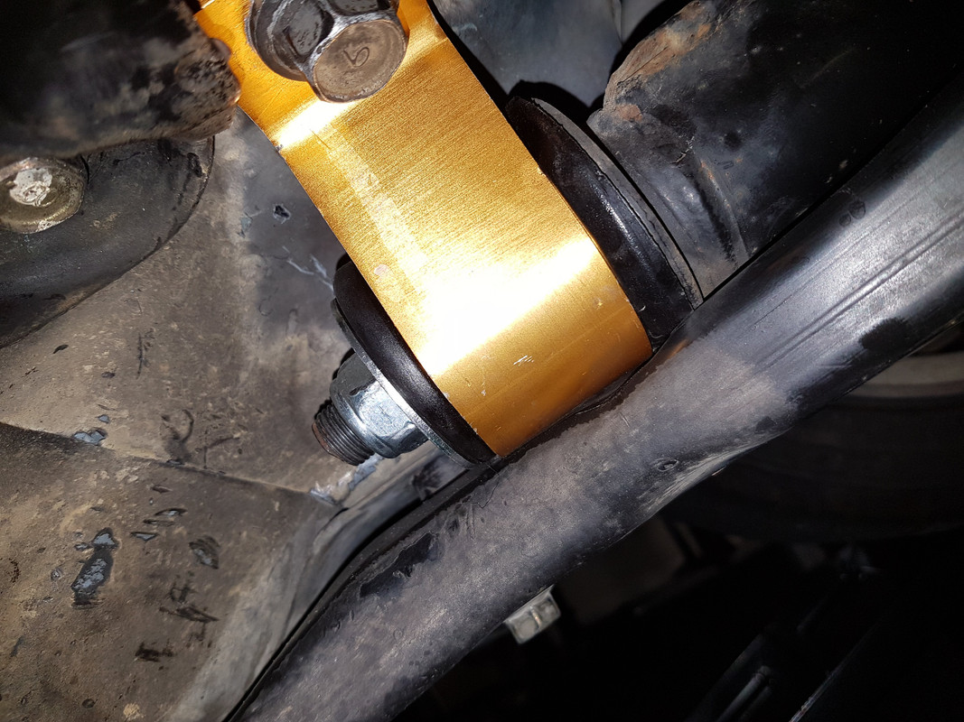

Finally fixed my dang squeaking noise (95% sure anyways).
So I lifted car off the ground, unbolted sway bar end links (to see if it still squeaks with them off) and still squeaked so I know its something to do with the Control arm bushes (specifically the Anti Lift kit) and not the Sway bar. I loosened front and rear control arm bolts, lowered car down on bits of wood, jumped around car to level the bushes again, tightened bushes back again and still squeaked. Was looking around and saw that the subframe was jammed hard up against the Anti lift kit and part of the bush so I unbolted the four rear 14mm bolts on subframe (2 on each side) and it dropped down about about 2mm below body. I knew this would be the noise so I put a decent washer in between the subframe and body and re tightened the subframe 14mm bolts, drove 50m down road and boom its fixed. The noise drove me crazy so im so happy I got it fixed. Weird no one else has had this issue...
You can see below its touching ALK and Bush.
After I installed washer you can see there is a gap now.
Glad you got it fixed! It definitely shouldn't be like that normally.
If you've got a WoF soon, take it down a gravel road for a bit, and get the underside a bit dirty. An inspector may have their own opinions about what you did.
I don't see anything wrong with what you've done.
In the kit there is supposed to be a series of spacers that moves that U brace down and allows clearance. Maybe you were given the kit for a GC/GF that wouldn’t include the spacers.
You can see one of the spacers on the left of this picture, there are supposed to be 6 or 8 in total.
As shown in this install guide. Proper (looks to be CNC'd) alloy spacer blocks. This is for the KCA359.
You've probably been given the KCA319A Subru, which doesn't have spacers (install guide).
Yep your right. Im pretty sure I have gotten more incorrect parts than correct ones at this point. The front essentials kit I got definitely was WEK076 (I remember checking the label) but came with WEK075 ALK and WEK075 front LCA bushes.

@Subru I was just thinking, you should space out the opposite side bracing like you did to stop the squeaking. Since the proper kit for your car has them.
