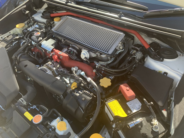

Installed the new strut brace from moonlight racing that turned up this morning ?
Nice! Now go find some twisties to drive!
Nice I got the same brace!
